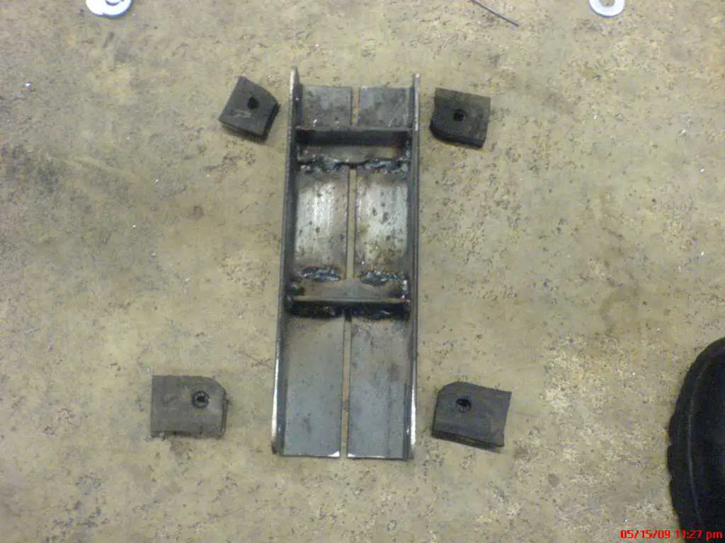

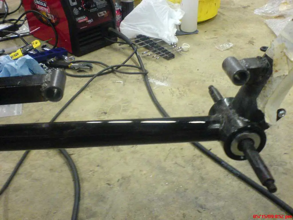

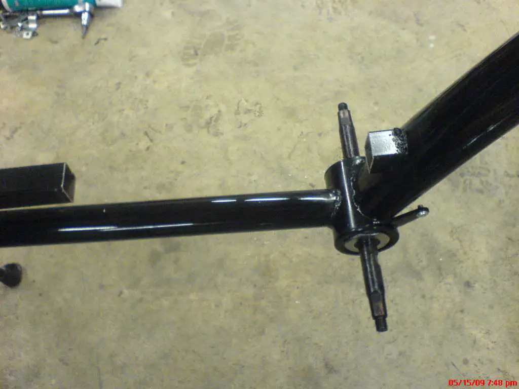

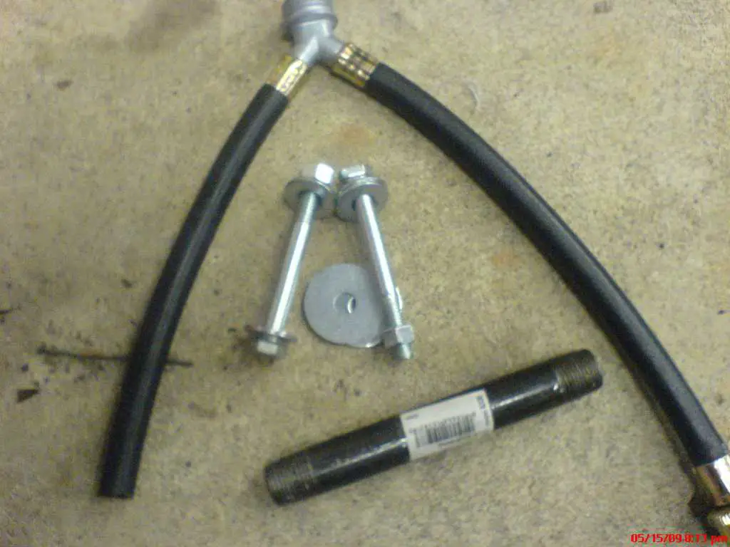

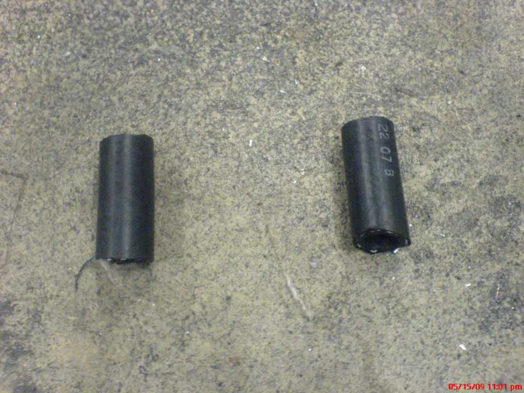

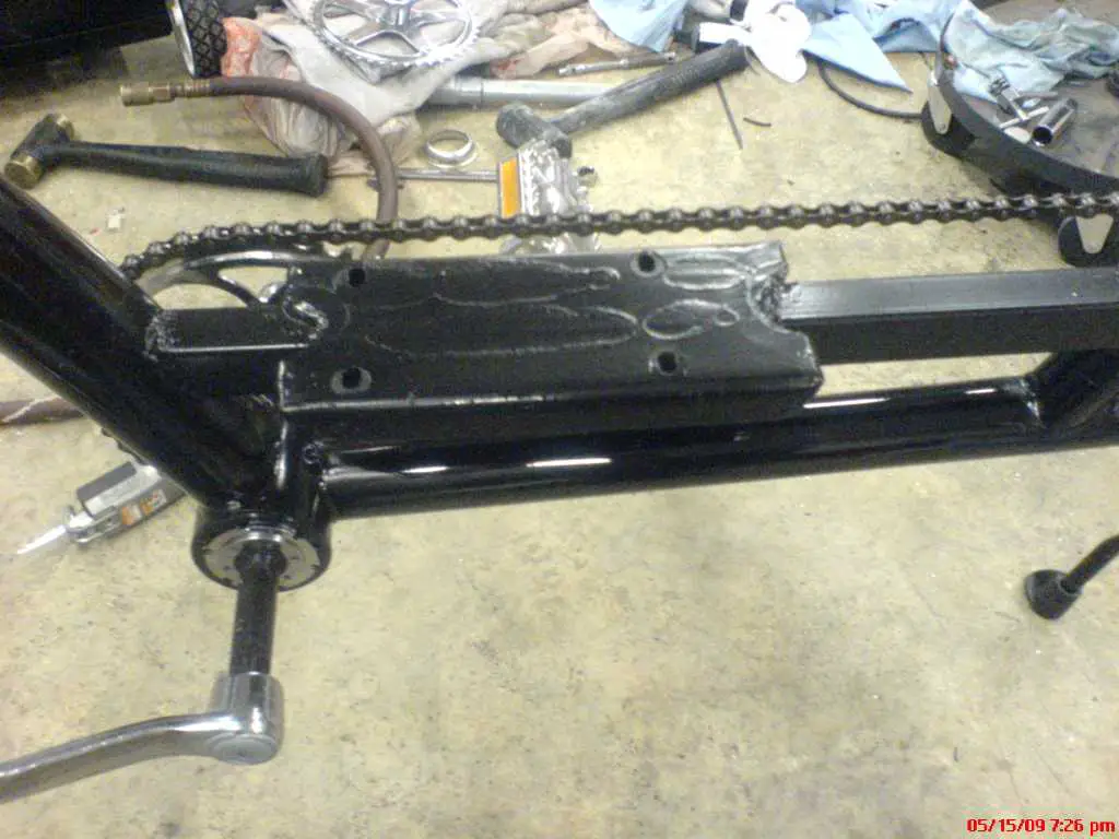

OK. This seems to be the ticket! I haven't ridden the bike yet, should this afternoon or tomorrow, but with the back tire off the ground and the engine running the vibration is GREATLY!!!! reduced.

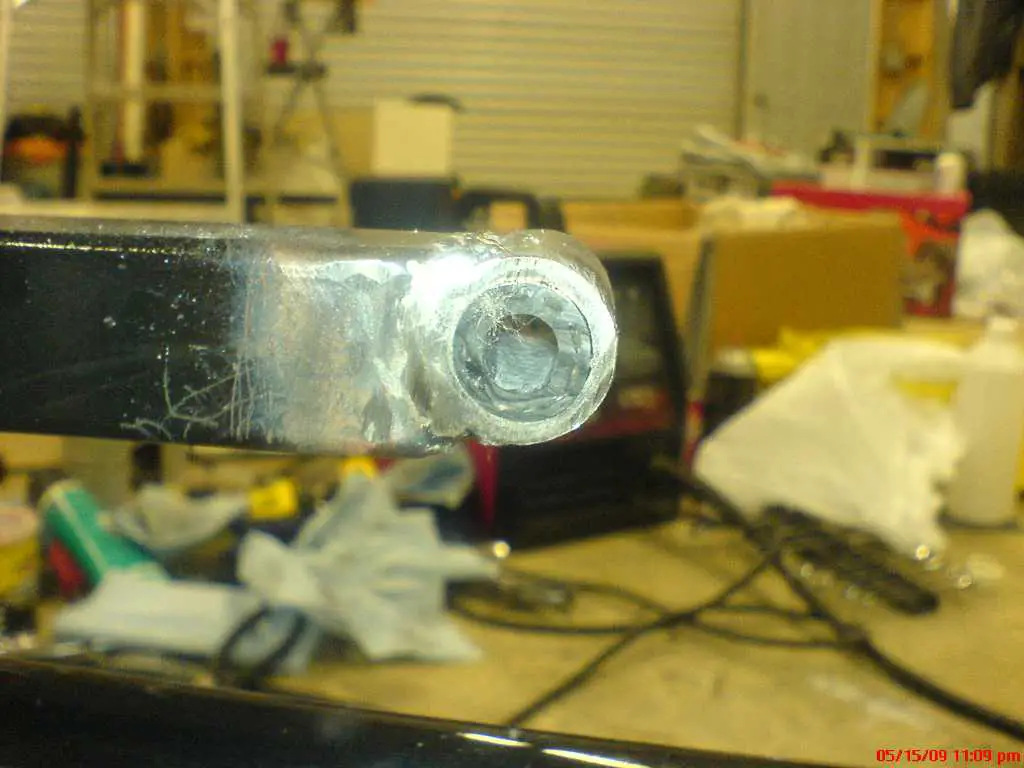

First, I cut out the original mount that I welded in.

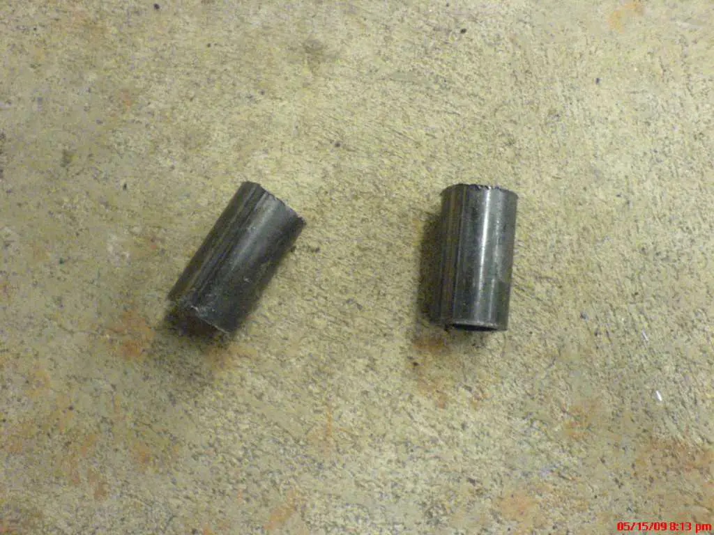

Then I took a 6" long 1/2 in diameter pipe nipple and cut it into 2 1.5" lengths.
I also cut some rubber hose that fits tightly into the pipe about 1.75" lengths.
Welded the pipe pieces to the existing motor mount and inserted the tube into the pipe.
Sorry, I think I have to reply again. Maximum pics.

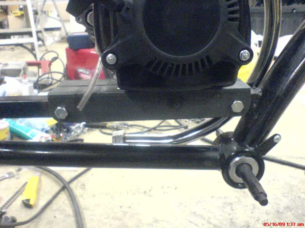

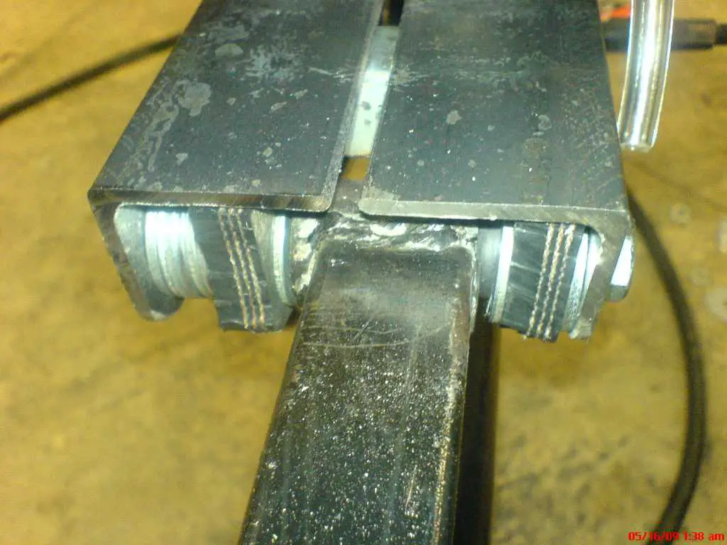

I also fabbed up another motor plate and cut some thick pieces of rubber to fit between the motor plate and the pipe to keep them from touching and allow for alignment. I was amazed at how much difference I could immediately see when I fired up the engine. I still have to paint and tweak a little, but it seems to work well. Hope this helps somebody.
