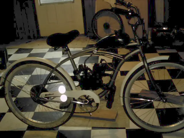

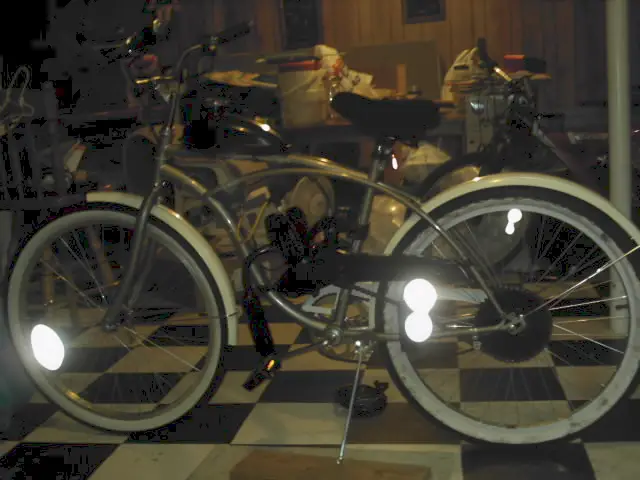

i just built a new bike, single speed cruiser. is there ant kind of tensioner made for the bike chain?my chain on the bike is loose i cant use it except to stop! i tried taking and adding links from both chains and cant find any happy medium.this is my 2nd build my 1st was a moountain bike..oh and how do i post pics ?

sorry ,but thats not the problem. i know how to tighten a chain and align a wheel the prob is there is no happy medium between the bike chain and the drive chain. here r some pics of both sides of the bike

Have you tried removing the chain from the engine drive side, tensioning the bike drive properly, and then reapplying the engine drive chain and playing with the provided adjusting tensioner?
You should be able to get both tensioned properly without a chain tensioner on the bike drive chain. You can buy half links from certain websites if necessary.

im gonna mess with it today some more. i just got it together yesterday. i had to make a frony mount for it. other than the chain its good. im gonna add a link back into the drive chain, i might have to have the tensioner maxed out which i didnt wanna do. thanx for ur helping guys

Your drive chain is too short add links to drive chain with pedal chain attached that will fix the prob. You will need to use tensioner on the drive chain do all this with the rear wheel in place with the pedal chain attached then make the drive chain longer removing slack via the tensioner .
Hope that all makes sense
