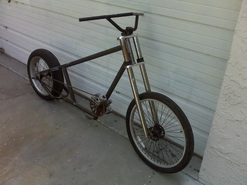

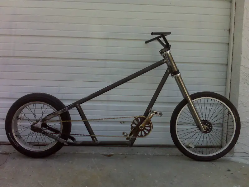

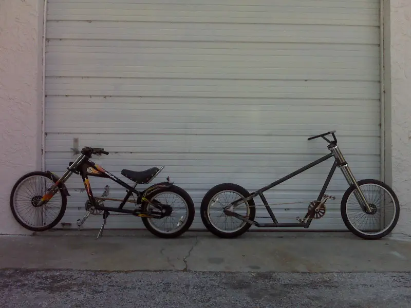

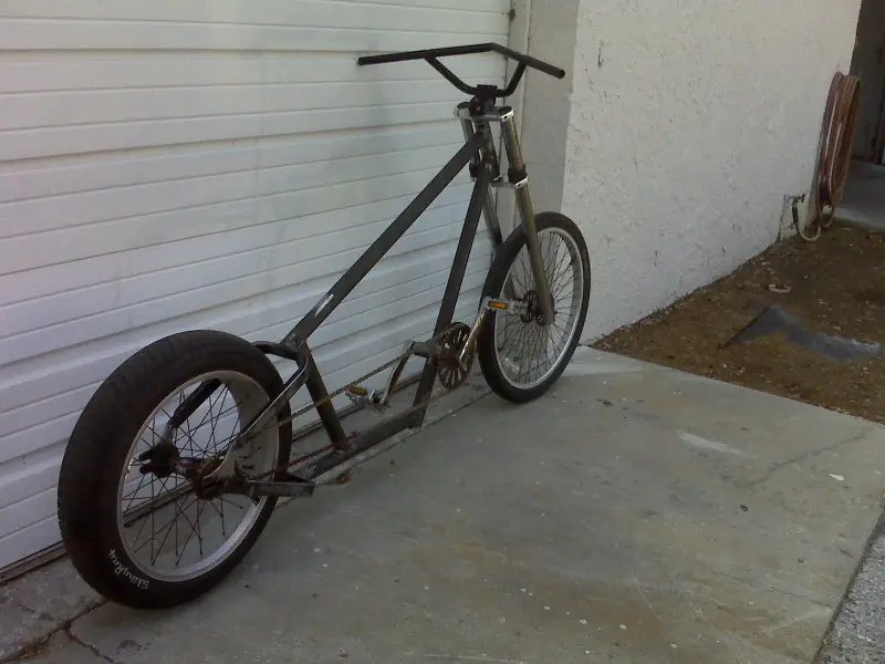

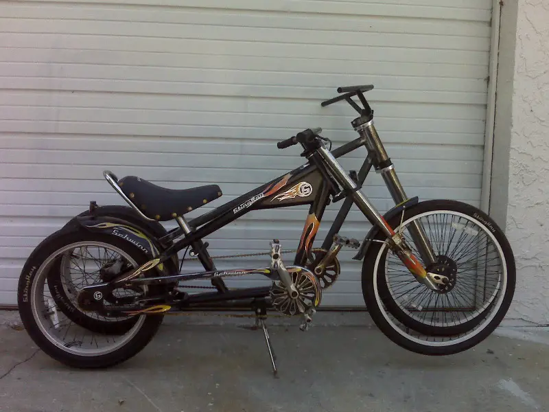

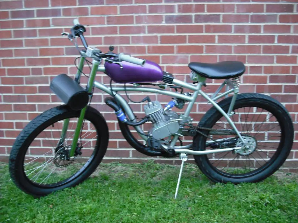

W'zup Choppah Heads,
I am please to announce that I am almost finished with a production chopper frame that will be available very soon. It is a Frisco Bobber style in that it is long and low, with straight line tubes and nice angles. The frame results in a bike with a 5 foot wheelbase, and the rake of the fork is completely nuetral in its' handling characteristics like a BMX bike. It's all in the frame design.
This bike utilizes the parts from a donor Schwinn Stingray, so you get the super fat 4.25" rear wheel and skinny tall wheel up front, along with the wider cranks. This frame makes for a bike that is very comfortable and will fit anyone from 5'6" to 6'3".
The reason for this is the bike will not have anywhere to insert a bicycle seat post.
Instead, I have a line on a motorcycle aftermarket bobber solo seat that has a pivot and 3" long suspension springs. There is no bike seat available that will provide the comfort and support of this seat. So therefore the seat can slide up or down the top tube of the frame to get it just where you want it.
This frame is made heavy duty, fully welded, but still light weight. You can reuse the Stock Stingray front fork, but I recommend a 30" springer fork to get the full "Bobber" effect. I will be building custom springers for less in the near future.
The frames will have a core charge; meaning I will need a donor frame sent to me for the build. Well, not the whole frame.... =-]' Simply cut off the head tube, bottom bracket tube for the cranks, and the rear wheel cage. This can be done with a cutoff wheel or hacksaw. Leave me an inch of the body tubes still connected to these parts. I will smooth them off the pieces I need myself. This will save a ton on shipping. (Like $11 as opposed to $35.) Send me your pieces, and in 10-14 days I will have a new Frisco Bobber frame sent to you to begin your build by adding you own custom handlebars (drag bars, apes, or something in between) paint, etc. It's yours to customize.
The bike is so nice and stretched, you can actually add a 2.4 gallon peanut tank for a motorcycle on it. Imagine the range.....
Also, for this frame there will be a production clamshell design isolated motor mount bracket and jackshaft assembly for sale as an option. simply bolt up the engine, add the jackshaft gearing, 5 speed freewheel, a 5 speed derailer, and a grip shifter and you are ripping through the gears like on my Orange Coast Chopper. I will also add the ABS Slotted Idler Wheels to keep the chain at bay under speed.
Just thought there might be an interest in getting an adult sized, fat rear tire buildable chopper frame for people who like choppers that ride and handle awesome, or people that have been thinking about it, but didn't have much option.
Here is some photos of what I have so far.
Let's get some response as I need some feedback.
Rock On!
'BrettMavriK

Great idea Brett....but not enough rake for my taste. Needs to be more like 47-50 degrees to make it look REALLY good. As it sits now its way too upright....like you ran it into a wall. Just my opinion....but the idea of a chopper/bike frame is a winner.

Glad you noticed that, man...
This is a Frisco Bobber design. The bike is designed to have the attitude of a chopper but the performance of a racer like they did to the old Triumphs back in the day. Hence, it is really a Bobber, and not a Chopper. Choppers came from the school of "how wild can I get and still go down the road without killing myself" appeal. It made for bikes that were inherently dangerous. If you notice the motorcycle chopper world that is going on now in the magazines, you will see there has been a transition from Glamorific and Chromosexual Choppers that have been out the last few years. Bikes are going back to their roots as everything else in the world. In the magazines, you will notice the transition.
OLD SCHOOL IS BACK!!!!!
Also, the fork in the photos has zero additional rake. The stock Stingray Fork has 10 more degrees of additional rake which would put it about where you would like it.
Anything is possible......
'BrettMavriK

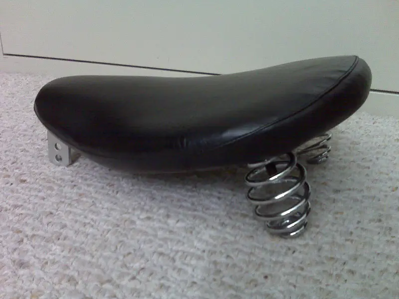

Wow! Those are going to be the starting point for some awesome MBs! I can vouch for the comfort of the seat you are going to use. I have one on my bike and highly recommend it. I am planning to use the same seat on my next? build, a Jesse James Chopper. Will you make a sliding bracket for the rear springs of the seat to rest on also?

Yes,
The seat will have a "Y" bracket that holds the pivot as well as the springs, and then a nice fat clamp to go around the bike frame tubing underneath. This allows the whole seat assembly to slide up and down the tube to get it just where it suits you.

Nice frame. It has lots of room for different engine choices!

i think it looks great. are you going to make some motor-ready? meaning, will you add some tubing or something, so a guy can just throw a motor on without having to fabricate his own mounts?

Yes, there will be a separate clamshell motor mount / jackshaft mount option made for this frame, so it's all a bolt-on affair. It will make for a fun and easy build on an adult sized chopper.
Hey Inzane!
Yep, the frame is made spacious, so if you want to go Non-Happy Time motor, you have plenty of room.
Here is a photo of the spring loaded seat which will have a y-mount made that will enable the seat to slide up and down the frame for exact rider size positioning...

Brett's making these at the shop. We've been talking about making an installation kit to go with the frames that would be simular to the kit I am making for the Jaguar.
The idea here is to build a frame and a few other components so that a nice lightweight motorcycle with pedals can be built.
Brett is a good welder/fabricator...I am not. The combined manufacturing talents could be used to produce an ergonomically correct bike...especially for taller riders.
For me a huge benefit to this comes from the fact that the bike will be made of U.S. steel, and manufactured according to U.S. techniques. In other words you will not end up with a frame and parts that are of suspect quality. At 30mph this can be a good thing!
The OCC's are a bit small, the Spoilers are hard to find...
Any interest in this guys? I realize it would be a lot easier to comment on a finished bike, but we are hoping to get a yay/nay early on.
