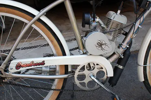

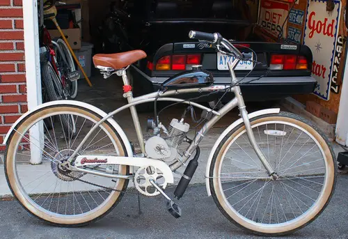

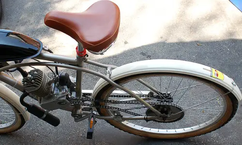

Brought the bike back from Florida this winter with the intent to put a motor on it.Turned out good and looks not bad for an 80 dollar bike.
Would like to thank the folks on here for what I learned lurking around
Only problem I have is the tire rubbing a bit. Not sure if I can space it over or maybe just buy a more narrow tire?

put a spacer on sprocket or move engine over a little.

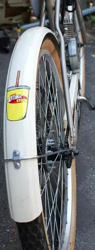

Your MB looks great.I had the same one,and put about 1200 miles on it with no problems,except the front fender mounting tab broke after about a week, luckily I stopped before it wrapped around the tire.I would suggest either taking it off or replacing the mounting bracket with something stronger. David.

Thanks for the info on the fender dvdtv....I did notice it shaking quite a bit the first couple rides.Could see how that might be dangerous!!
I have a Schwinn also but I like the way the front down pipe is wider on this bike.I smoothed out the front mount with a die grinder and an 80 grit flap wheel and it fits like a glove on there.No vibration at all really but for tha fender! I think I will definately be checking that before the next outing :d

It's more important to make sure the chain is lined up between the sprockets...be carefull when adding spacers or moving the engine over (not sure how you'd do that).
A light tire rub is not bad. I use 190's with no problems. I will suggest going to a thinner tire if it rubs too much.

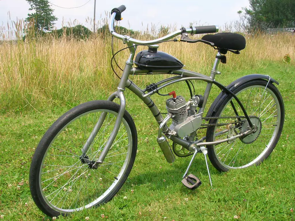

Huffy Cranboob with 190's....no tire rub.
Front fender mounted on rear. "custom" paint.

HI! i just built this bike too! (not sure if you still have the problem) but, mine rubbed the tire too. I ended up putting some thick lock-washers between the Sprocket & the packing material on the back wheel.
After tightening up the sprocket and aligning the wheel as best i could, the chain had about a quarter inch clearance from the wheel. So far So good!!

i used a spacers on my rear wheel between spokes and sprocket and now my chain clears the tire.
an i didnt mean move the whole engine over,just a little tilt and tighten.
and i didnt have to bend no arm or drill out the sprocket hole,i just removed the dust cap.
