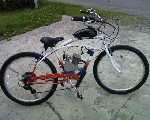

Got both my PK Jet 80 from zoom cycles and My Schwinn landmark dropped off by ups today.
Plans are to drop the seat down and back along with a different style handlebar.
I'll post pics as I go.

Here's where I am as of now. Gonna lot more work to do before it suits me.

Hi Smallblock,
Looking good. Didn't know I had company in building up one of these Landmarks. I've attached pics of my Landmark build using a Hua Sheng 4 stroke and firebelly transmission. In case you want matching paint for your gas tank, you can get a very close match using Duplicolor metalic burnt copper spray can that I found at my local Kragen. I've also reviewed the Landmark on this page http://motorbicycling.com/f31/bicycl...ew-6916-4.html

I bought some copper colored dupli color paint and it was way to light. I just went to auto zone and picked up a can of what I "thought" was the right color. I'll have to see if i can find the metalic burnt copper.
Where did you get the handlebars? I don't like the stock ones and the ones you have are exactly what i had in mind.
I really like yourt tentioner design also.
