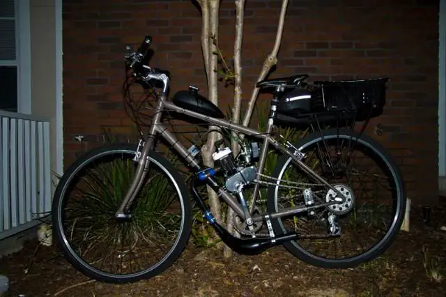

This is preliminary as I am awaiting a new rear tire and CE clamshell sprocket adapter w/32 t sprocket. Then I'll tune everything properly. I have no other experience to compare this to but the smile it has put on my face makes it worth the money.
Power
This exhaust delivers performance beyond what you pay for it. I haven't tuned the carb yet, but it pulls so much harder on the lowend and runs really smoothly. It ran up to 33 and held it, even on small hills where it would typically fizzle down to 28 or so. Once the new sprocket is on I have no doubt it will have the power to pull up to 35 or so mph. If I am cruising at 20 or so and pull the throttle all the way back it the bike jerks forward with torque.
Installation

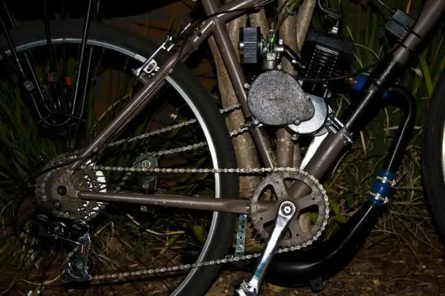

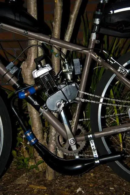

Installation is simple, even for a very intermediate mechanic. The instructions on the website are awesome. Basic tools are needed as well as a dremel with a cutting/sanding wheel. I had to trim about 3/4" off the adjustable pipe just for it to clear my front wheel. The copper exhaust gasket from CE/MM was included and made the deal that much sweeter and installation that much easier. Since I painted the pipe and was too impatient to wait for it to fully dry, the pipe from the header to the expansion chamber kept popping off, regardless of how hard I torqued the clamps. Once I stripped the paint from that area it held on.
Sound/Aesthetics
The tone is awesome. At idle it is a much lower/throaty idle. When crusing you have a nice pingy blap blap blap. Under acceleration I didnt notice much difference in sound than with the OEM muffler. WHen decelerating you get the occasional pingy backfire. Overall the sound it makes is great.
Aesthetically I like it. It works well with my mountain bike frame. I could see it looking out of place on the cruisers, and what not. I had to paint it black because the chrome was just too much.
Well thats it for now, I cant wait for my new tire so I can put some more miles on the bike. Great product at a great price! Get one if you are at all on the fence about it, you wont regret it.

Thanks and nice job on the install. My only comment, and not really a big deal, is you could gain a little ground clearance by sweeping the pipe back a little more so it is more in line with the frames downtube. This would increase your ground clearance as well as create a little more space at the front tire. It would make your muffler point a little more in the upward direction. Would probably cause you to fab a different rear mount. Overall though these are just personal aesthetics and what I would do. Looks great and glad you are happy with the performance.

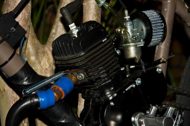

Are those blue parts silicone tubing? I didn't know it would last so close to the exhaust port. No problems at all?
Hi temp (read expensive) silicone tubing is perfectly fine. Holds up to the heat and flame great. The worst thing you can do to it is use cheapo hose clamps a tear it. The upper ones are just for sealing.

mekano, they seem to hold up very well. You will smell them burning a little bit on the first few runs as they settle in, but after that they seem fine and seal very well.
