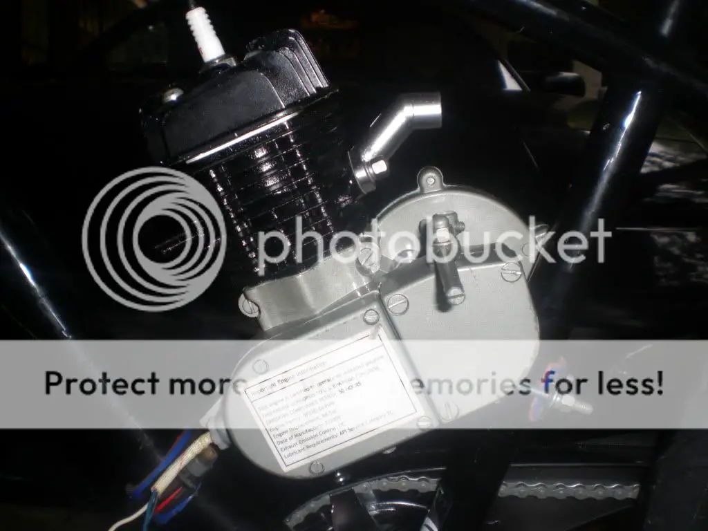

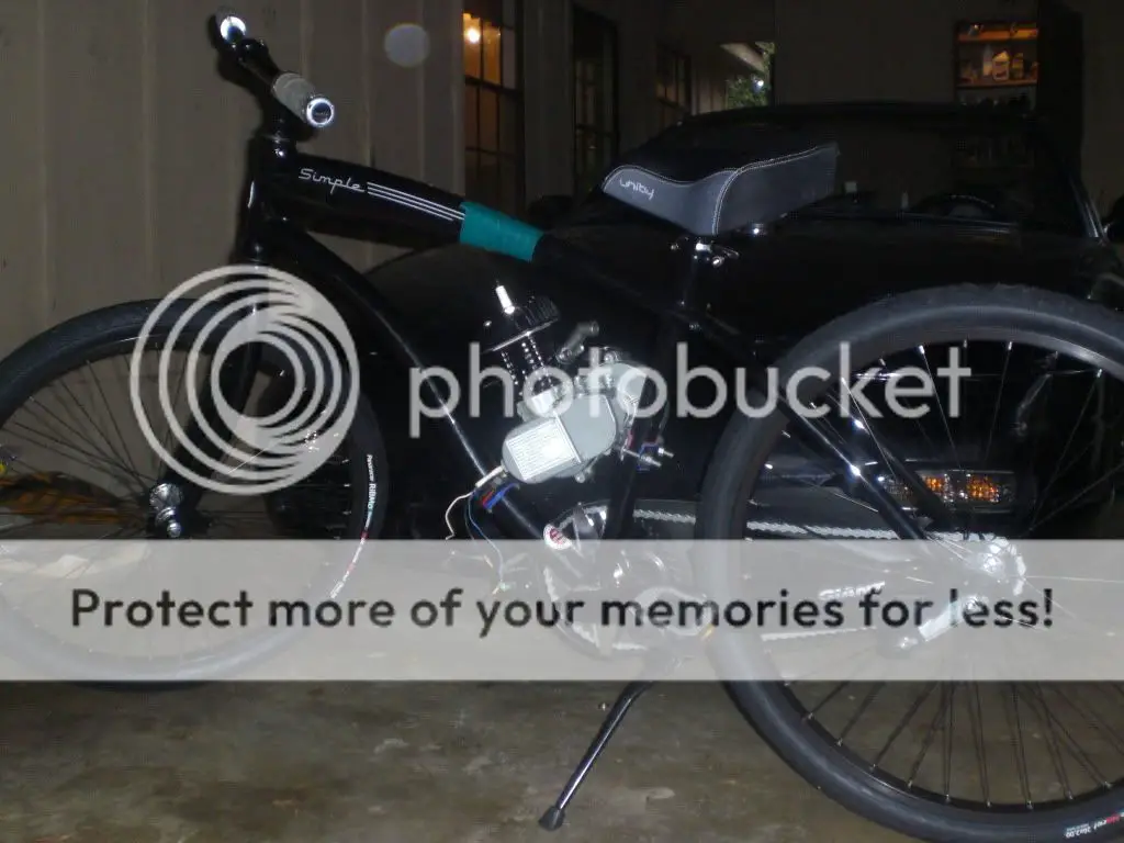

This is what I have so far.

after deciding I hate the way the sprocket mount I bought a Manic Mech Spocket mount and sprocket and will just get the cables set up.

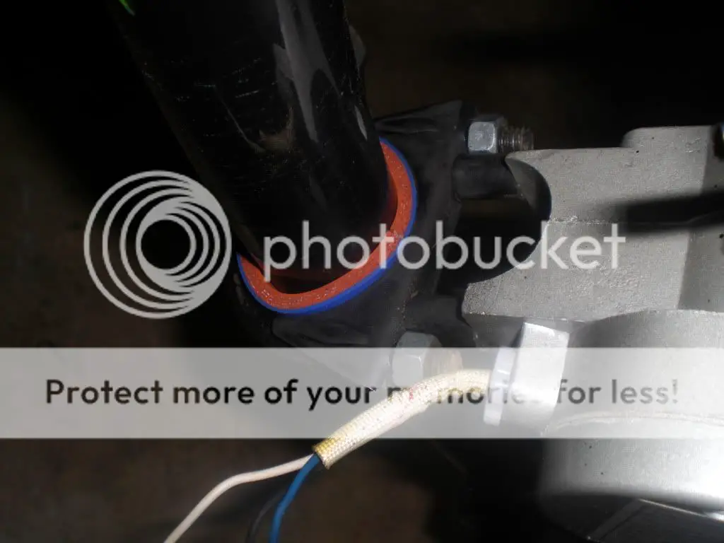

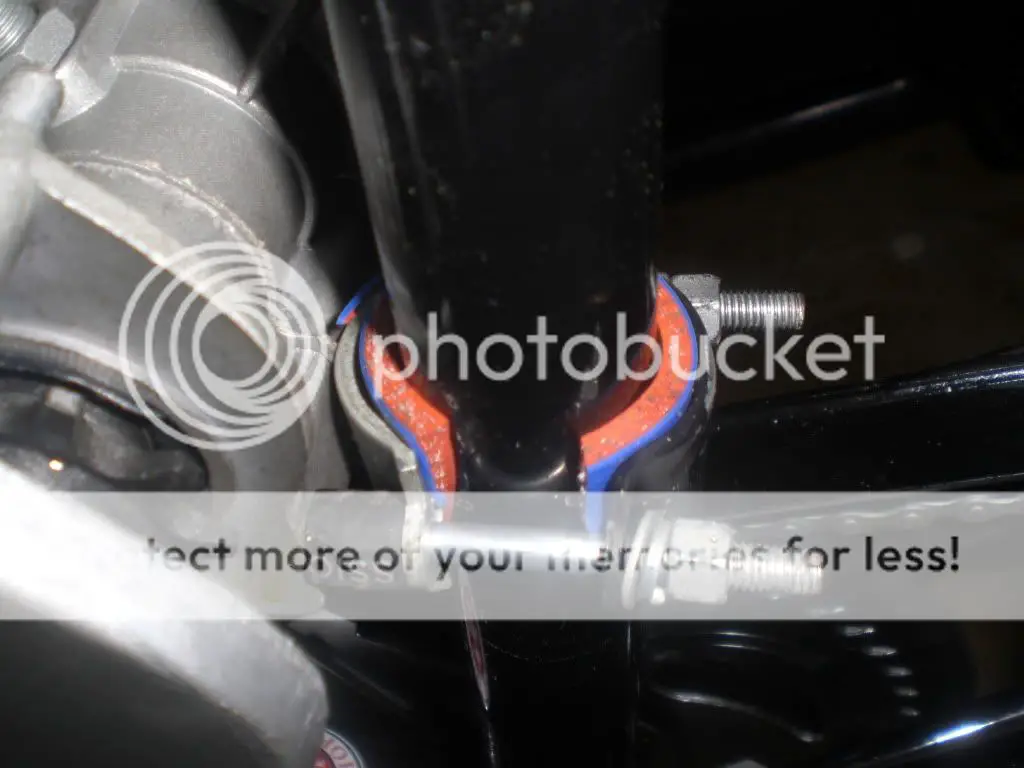

where did u get that front mount from?
made it with an exhaust clamp. I had to make a slight redesign though. I used abigger clamp also so i could put the silicone tubing around the frame to absorb some vibration and protect the aluminum frame.

I have the same issue with an oversize aluminiun tube. What size clamp did you get? The one I have now won't allow to use a rubber tube to aid in vibration suppression.

And what size clamp was that????

Posts: 21
Default Re: Giant Simple good start for Chinese kit
the clamp is 2 1/4". I could probably use a 2" though. I ended up making a plate to offset the mount, so I could mount the enigine lower b/c the carb wouldn't fit.
