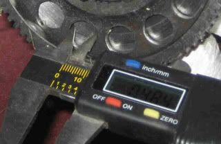

I finished the tool for the round pads a week and a half ago...at least I thought I did
I punched some out to test. Everything was going according to plan. These were punched based on the diameter of the holes in a gear I had on my desk from a dissassembled engine.
Sooo...I took the cover and pressure plate off of a customers' bike thinking I would test the new friction material. I knew his clutch used the round pads, because I have worked on it before. The holes in this gear are 1/16" larger than the one I went by.
Fortunately I designed the tool to have interchangeable punches and dies.
Unfortunately, before ordering, the customer is going to have to take the clutch apart and determine what size and shape they need.
I will make the punch and die set for the trapezoids as soon as I can test the material.
It seems like there is always something to throw you off track when dealing with these engines.
I wouldn't be the least bit surprised if there is even a third round size, and possibly several sizes of trapezoid.
The first 5 people to post pics on this thread of their clutch gear, being measured with calipers, will get a set to test.
I have friction material for a gear with .475" diameter holes for the pads ready to ship. If your gear has .535" diameter holes, or the trapezoids, there is no need to post a pic. I only have the one size available.
I need to get this going, but in the event the chosen material is wrong; I don't want a bunch of them out there.
