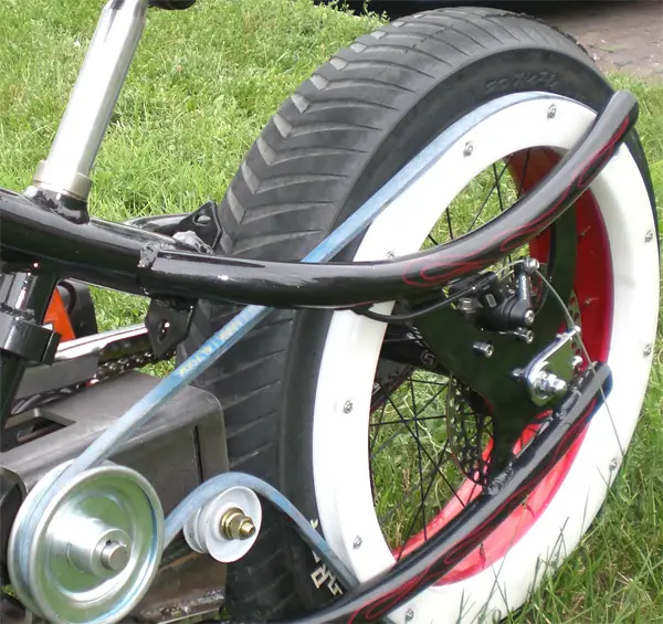

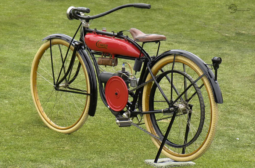

some use a belt and plastic rim thing about 20"s or bigger,
like a whizzer,then you wouldnt need a gearbox.
