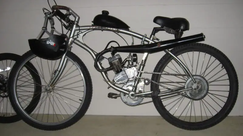

My MB. [IMG][/IMG][IMG][/IMG][/IMG][/IMG][/IMG][IMG][/IMG][IMG][/IMG][IMG][IMG]

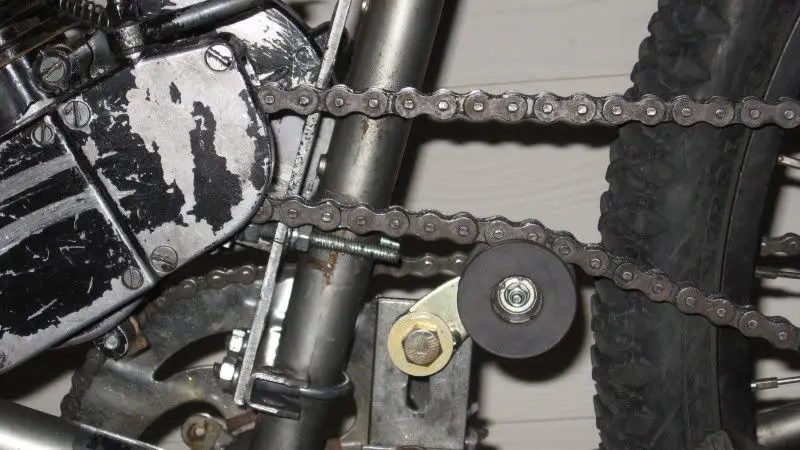

Good to see more people enjoying there mods. The gas tank lid made me laugh! The tensioner your pipe way cool.

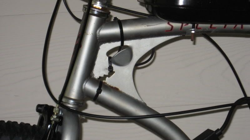

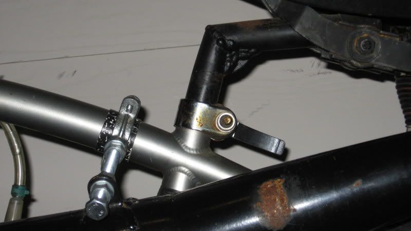

Here is some more details of my bike. I fabricated the header from electrical conduit elbows and the stock flange. The pipe has an old seat tube quick release to secure it. It is held to the frame with a plumbing pipe hanger and 3/8's" bolt from BLowe's. Both frame mounts are homemade. I see that SBP had the same idea for their rear mount, great minds think alike. Anyway, I think the bike has taken on a scrambler look with the pipe the way it is. It seems that the more work I put into it the less I like to horse around on it. The streets here in Charleston sc are down right brutal. I associate riding here to be like riding around the Gaza Strip. Potholes are everywhere! Oh yeah That last pic is a bottle opener.
