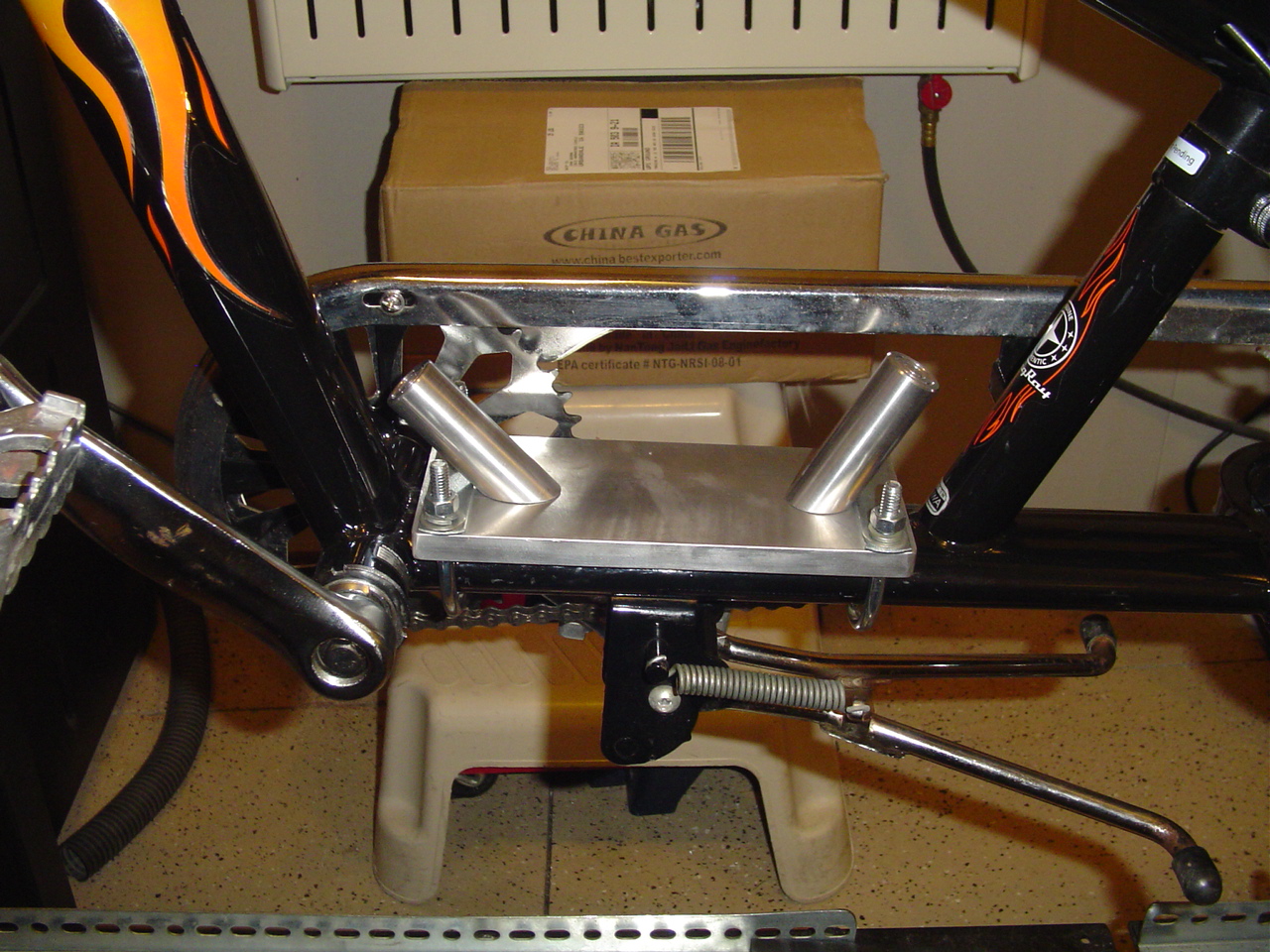

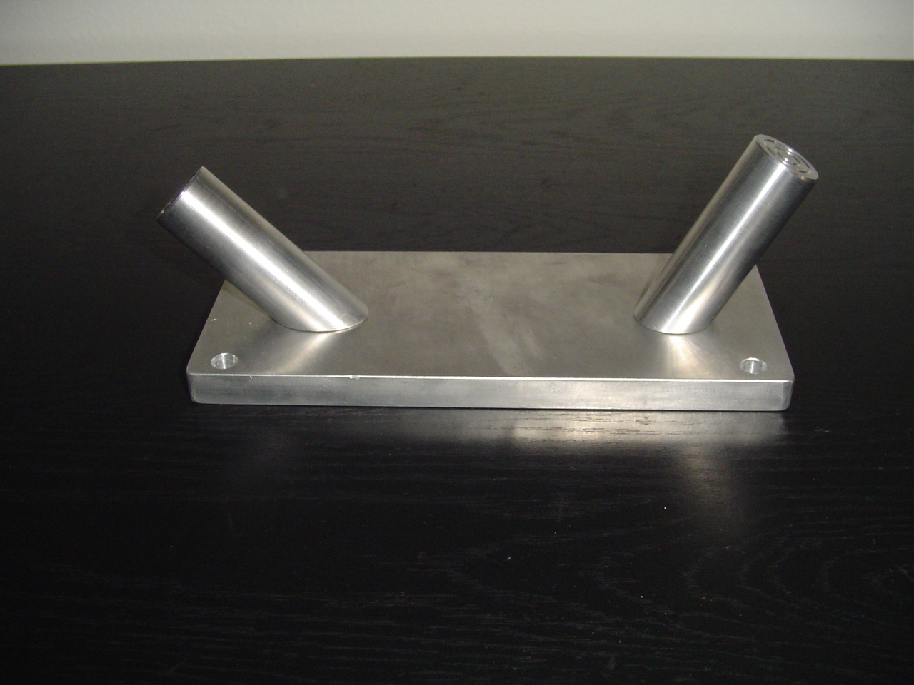

You do know it takes a fabricated motor mount to set the motor about 3/4" off the centerline to clear the 4 1/4" back tire. You will also have to build a new exhaust. The kit exhaust will not clear the frame.

Pappy, I machined the mount. You can buy them off e-bay from a guy named Barry. He also sells the exhaust pipe. I think he gets about $50 for the mount and $70 for the pipe. That is why I built my own. I do have the advantage of having a small machine shop.
