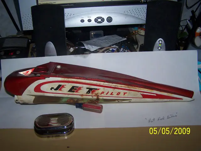

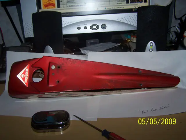

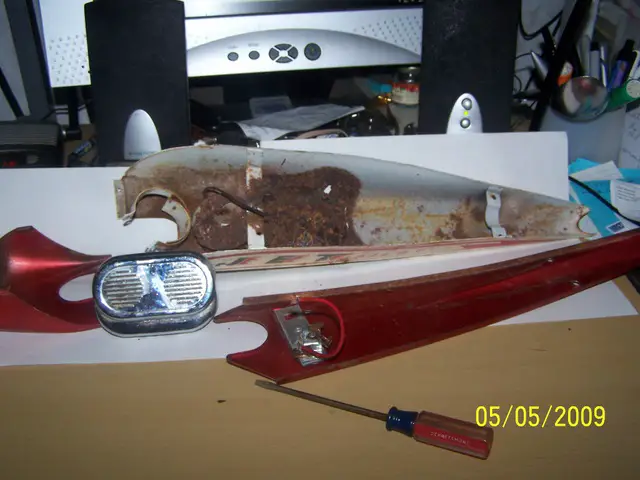

I Will Post A Pic Of A Tank I Bought On Ebay . Jet Pilot, Roadmaster Amf. Nice Build Prof, And Welcome. Ron

I Seen This Tank On Ebay A While Back And Bid On It, I Don`t See Much Like It, But It Is Not Gas Tank Material. I Sort Of Forgot About It Till To Nite. With The Prof`s Pic`s And Rot Rod By Seca. IT HAS JET PILOT ON THE SIDES, ROADMASTER AMF ON THE TOP. IT ISN`T MUCH, BUT I DON`T SEE THIS KIND OF THING ANYMORE. RON

Neat times- That tank is incredible.
Kinda makes you want to find an old semi rusty red frame so you don’t have the repaint the tank.
