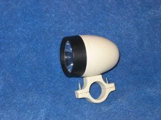

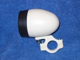

This is my new light the mount fits "1dia bars. comes unpainted so you can make it any color you want very little sanding to finish use can use model car paint or auto paint. Comes with a micro switch wired up and ready to go. Switch is mounted in the side. In this photo I do not have the switch installed I can either mount the switch or you can, same for the mount. I also have a 7/8" dia. mount its a little different.
this is for 1" dia bars
this is the light with the 7/8" dia. mount and is a different style.

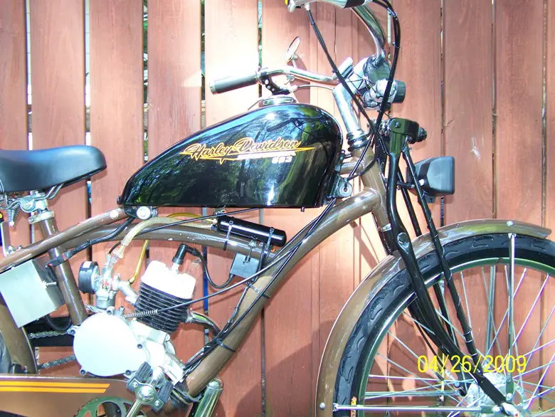

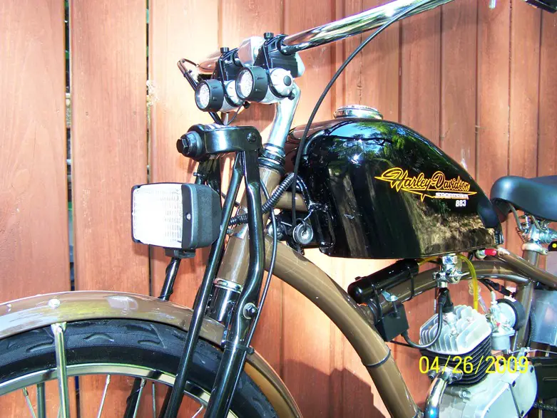

I used a tractor light or implement light that I bought from WalMart for under $12.00. It's very bright with a 40 watt bulb and I powered it with a 12volt 4.5 amp gel battery for an alarm system. It will last 2-3 hours before it needs to be charged from a trickle charger overnight. I made a battery box from aluminum
project boxes available from most electronic stores. I guarantee you that it will be sufficient for night riding. see pics.
