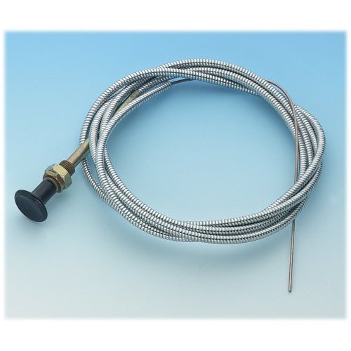

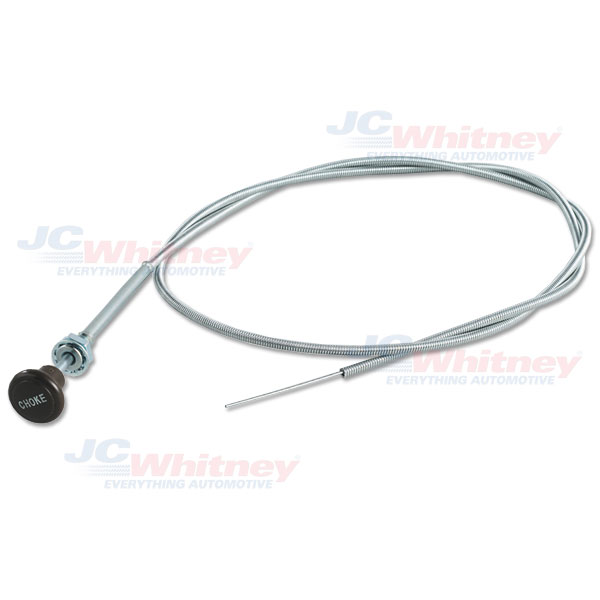

Mr. Gasket 2078 choke cable $10.00. Check out JC Whitney, I beleive they have alot of choke cables to offer you. Your local auto parts store should have choke cables.
