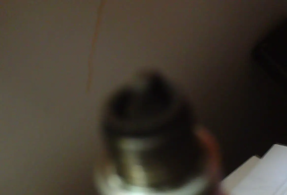

Default Re: How fast is your Schwinn OCC
I don't know. I upgraded to hp spark plug wire and cap from sickbikeparts, and it improved a little. I used directhit, which works better in the winter, but I could not get to 20mph. The Directhit makes the engine sounds very crazy in the summer.
