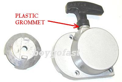

The plastic grommet that protects the pull rope from being severed by the edges of the aluminum housing on my pull starter was damaged and didn't stay put. Like an idiot I ignored it, until the rope severed and broke (duh). I ended up completely disassembling the pull starter and having to rewind the spring (that sucked). I recommend using a pair of vice grips if you ever have to rewind the spring.
