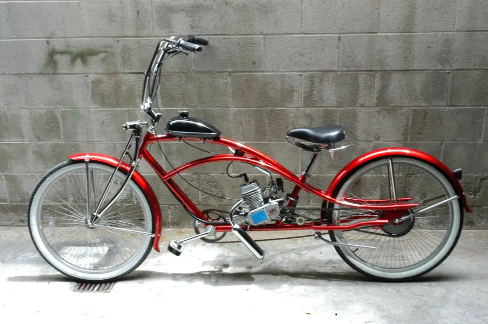

hey all, allmost done with my new micargi mustang gts cruiser heres a pic Rob.........

Nice looking bike. I really like the look of the stretch cruisers. That's the same bike that is in the banner up top. Be sure and check the welds on a regular basis. I've had two Micargi stretches and both have cracked on me.

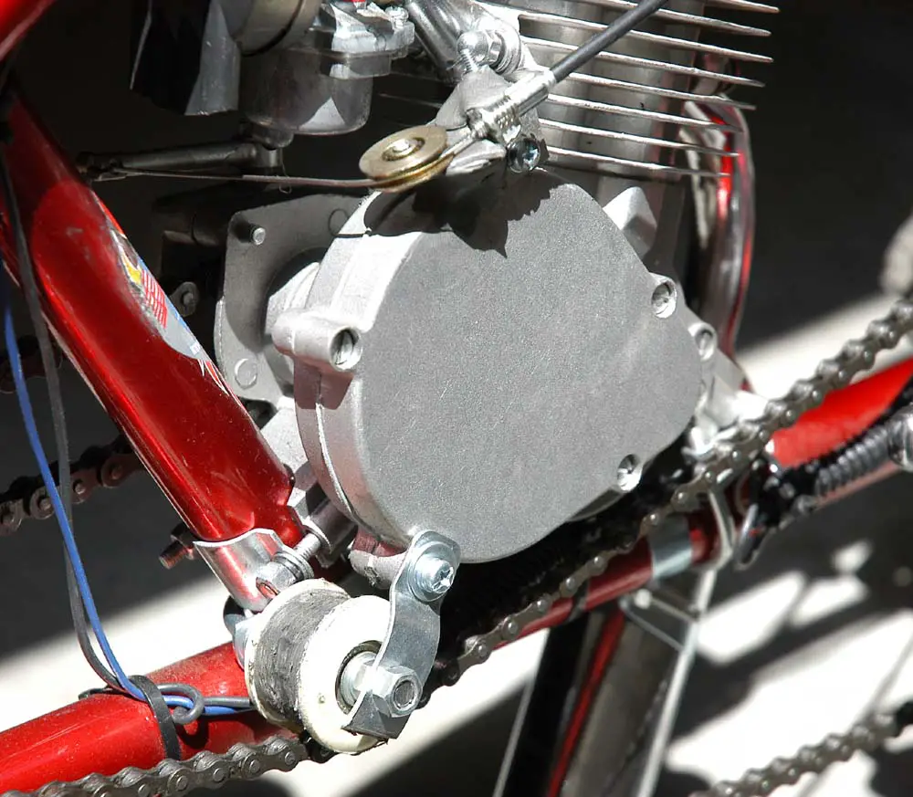

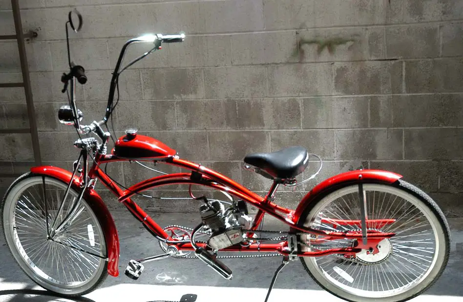

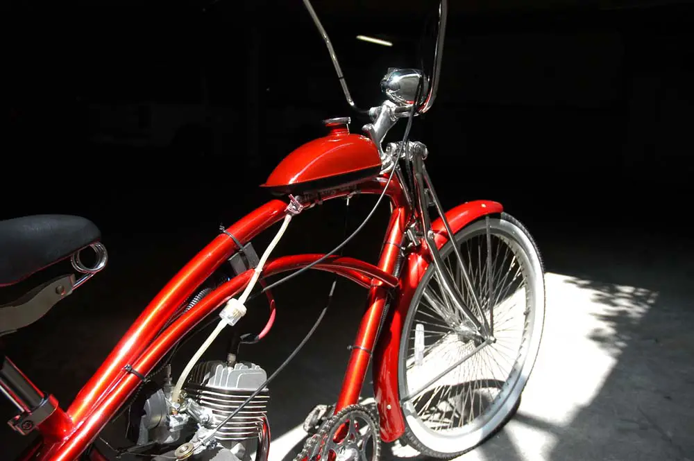

finished dialing her in and a few little touches, painted gas tank (color of bike) shortened the rear fender, pulley clutch mod (way smoother) and some custom pulleys.

How on God's green earth did you get the sprocket on those spokes ??

yeah getting that sprocket on with those spokes was a nightmare, my buddy and i did it and it must be what doing surgery is like,

no didnt bend or remove any spokes. just carefully and slowly used extra long needle nose pliers to carefully place the nuts on the bolts and get them started with the tip of the pliers. then i was able to get a 10mm socket thru the spokes to hold while tightning from the outside (it took about 3 hours)
I wont use that type of wheel again, the people at the bike shop wouldnt trade the wheels out for regular ones.
