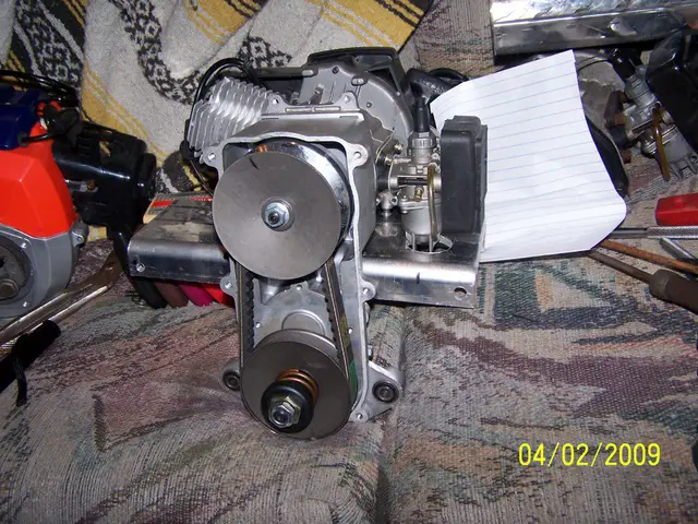

The 10 tooth sprocket the Titan kit comes with is a bolt on. The mounting bolts and the clutch bell it's all a bolt on,man.

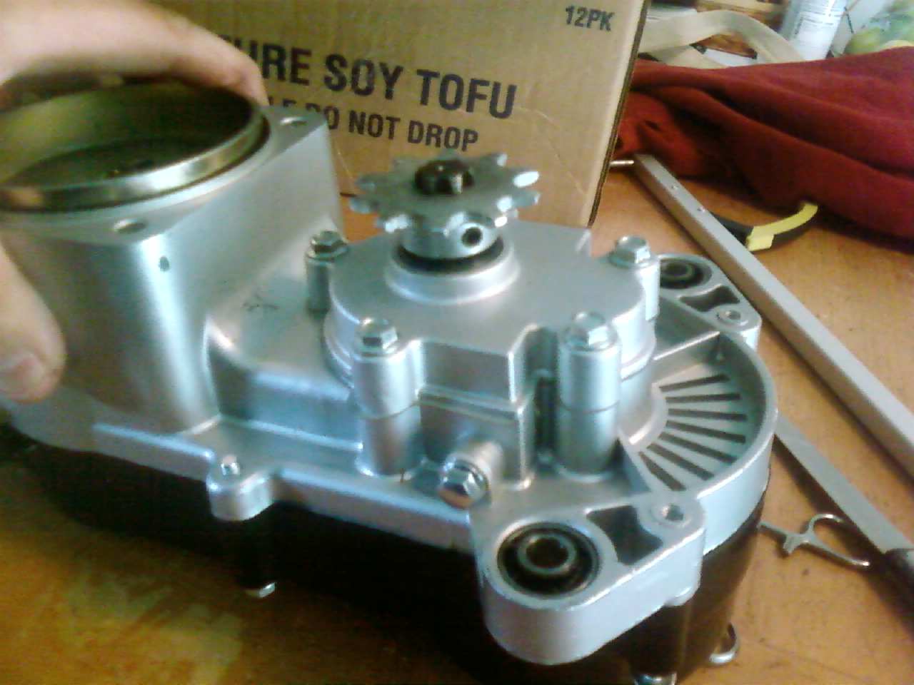

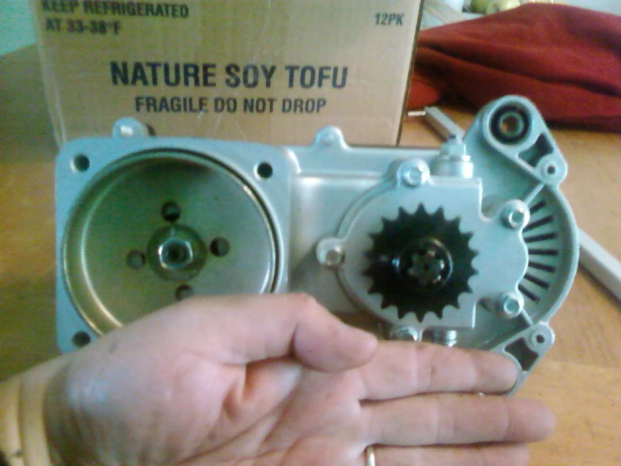

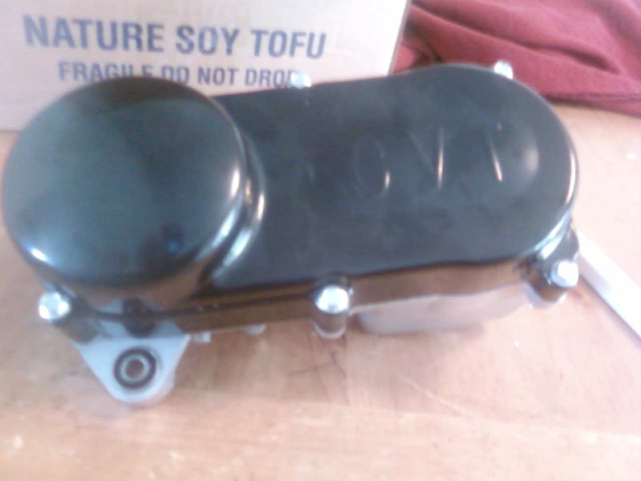

2nd pic shows that this tranny isn't really that big by looking at my hand or something.

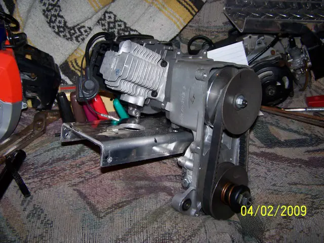

3rd pic shows the Titan sprocket. the c clip wouldn't go on but that sprocket has a tightening nut.

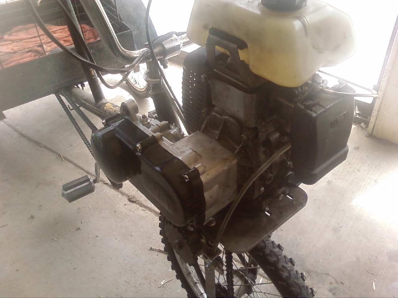

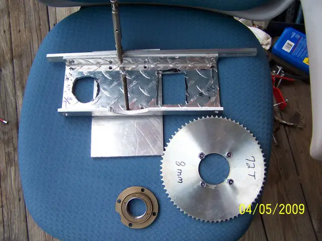

Okay so I ran into a little glitch.
Picture 1 shows the sprocket alignment that's cool though because I can just flip that huge sprocket
around and it will line up but with the engine all the way up it the chain won't clear the housing.
I want to retain the 3 speed for now so I can choose what permanent gearing I want to go. This is the early Titan aluminum carrier.

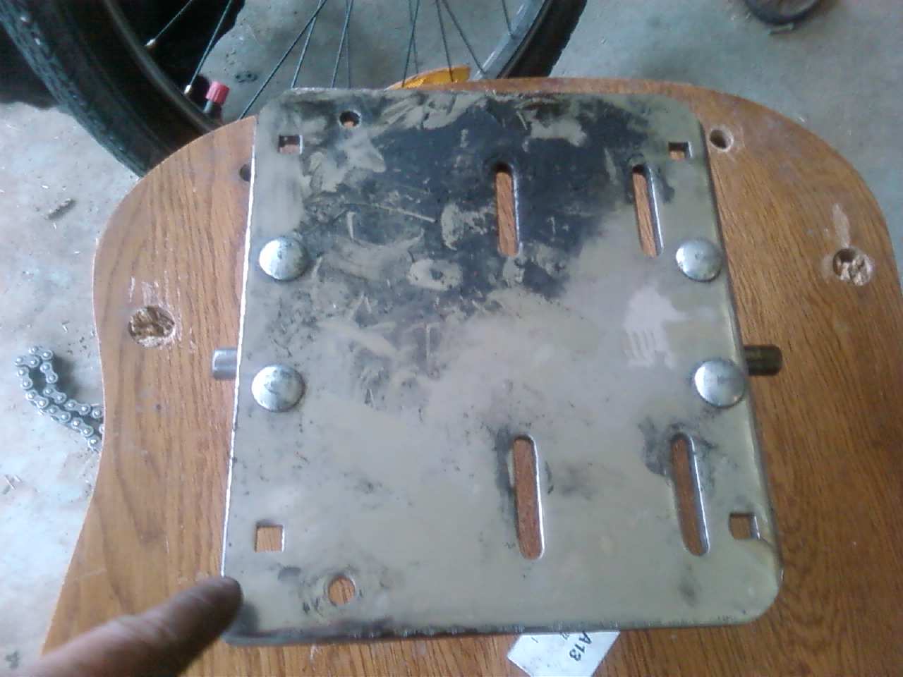

Picture 2 shows the current Chrome Titan carrier I had laying around. Sorry it's a little dirty. OH LOOKY HERE!! Extra mounting holes!! With this I can have the sprockets almost vertical of each other!!

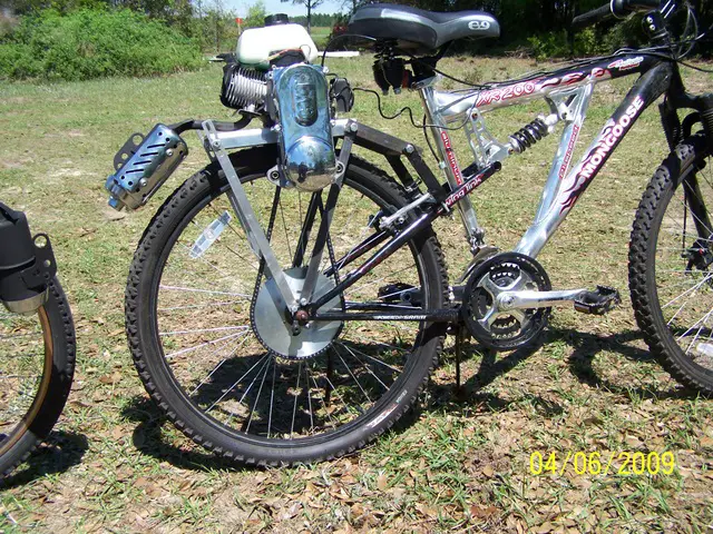

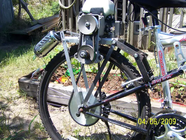

Lf, Here Is Some Pics Of My Build, It May Give You Some Ideas. Ron
I thought about mounting it that way and possibly doing away with the jack shaft but the jack shaft in
my bike is important for gearing and alignment.
What kind of freewheel are you using?
I am thinking of using one of these Heavy Duty ones with their 48 tooth sprocket on the rear wheel
