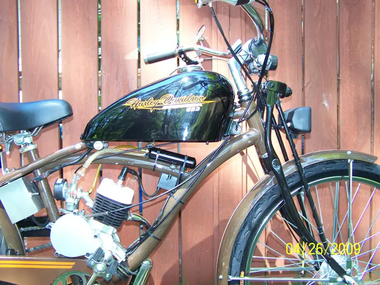

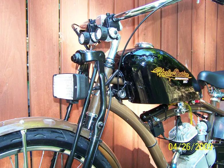

Here's some pics of a Harley Sportster 883 tank, 1986 that I mounted to
my bike. It really gives it a "motorcycle" style look to it, plus I have 2 gallons
of fuel capacity and a quality petcock valve. I get a lot of compliments on it.

Wow Outrunner, that tank looks like it belongs there! Good looking bike.

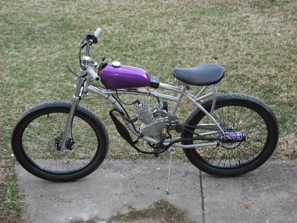

I used a tank from an early model Suzuki JR50 (kids dirt bike) I think it looks pretty good but I wish it was a little bigger. It holds about what a kit tank holds.

Hey Marvin, I like that tank that you used too. It mounts OVER the
frame rather than on top of it and looks great! I hate the look of the stock tanks, they sort of resemble an adult wearing a childs hat that's too small!! What an extraordinary exhaust system you made, does it perform well?
