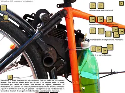

to bring it back later) You'll need enough to reach the upper frame member or handelbars to get a syphon feed to the carb. (like the Cuban kids do with thier Riquimbili bikes) You'll also need a piece of
wire or string of some kind to tie the neck of the bottle to the frame or handelbars. Fill the bottle half way or so with fuel and connect the line to the carb. Now, place your lips over the neck of the

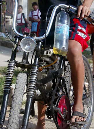

#3 suggestion for the future. Have a piece of line that can splice onto your fuel line at the petcock
with clamps on it that's long enough to reach the handelbars. Your spare fuel (one liter bottle)
should have a wire tied around the neck where you could fit a shower curtain pin under that wire
and slide that over the handelbar and then clip it in the closed position. This way you can run
the piece of hose from the bottle on the handelbar to the existing fuel line and ride home. But
you will have to blow into the bottle with the line in it to get the fuel over the top of the bottle
so it will syphon down to the carb and provid gravity feed.
