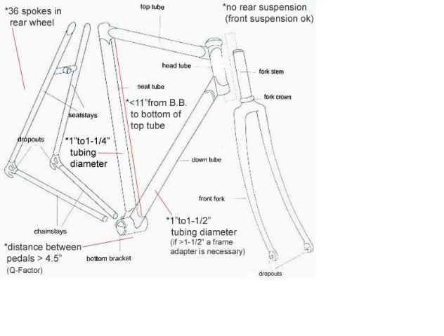

Hmmm.... was looking online had trouble finding a pic of one.
Click on the pic below, it will have the dimensions you need for the in frame two-stroke kit.
And you could always go with a front friction drive or rear rack chain or friction drive as well.
