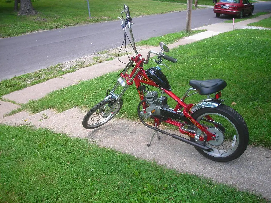

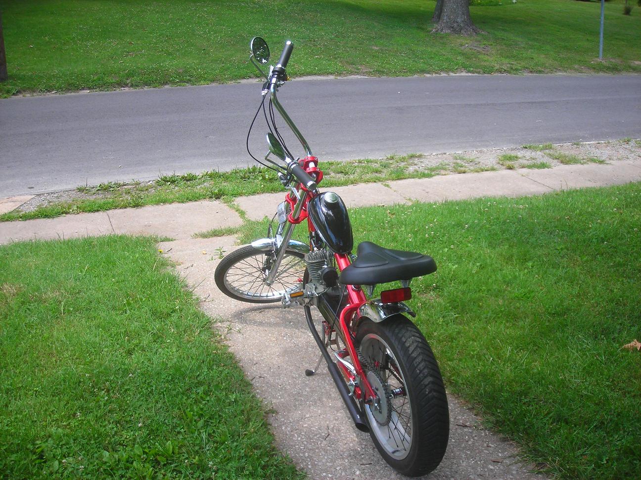

I do not have a WCC, have only seen them in pictures. I do have an OCC, and I changed out the forks with the rare set that has front brakes and a 20" tire. Also replaced the handle bars, added a dual cable brake lever, and reduced the seat post size by way of sleeve inserts to 1" to accommodate a lay back seat post and a 13" coil cushioned seat. Compliments to Bike Barry for the motor mount and the exhaust pipe and to Manic Mechanic for the rear sprocket and sprocket adapter!

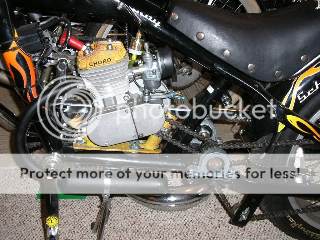

my buddy (outlawchopper) doesnt have net right now so allow me to tell you the nightmare which we had to go thru to get his up and running.
first off the cheapest engine kit we could come up with was an 80cc black slant head from boygofast. however,they shipped the wrong engine,we received a standard 80cc silver engine kit and we didnt have time to argue and fuss about it,we just had to make due. i dont have chopper's permission to release photos at this time but i can tell you right now,if you are doing this on a budget and cant afford custom machined parts your going to have to design and weld up a custom motor mount, either cut the crank and weld an extension on it to clear the engine or hope a 3 peice crank will be wide enough to clear the engine. also for the chain to clear the frame and bulbous tire on this bike was a miracle of trial and error, we still have yet to perfect it,but it works well enough for now. we had to ditch the coaster brake hub and rim cause the stock spokes wont accept the 9 bolt thru the clam shell adapter also the coaster brake is in the way even after heavily modifying it. we used a freewheel and made custom brakes.
currently i dont know of anyone who has custom machined parts available to make the engine install any easier but you might want to contact creative engineering MANIC Mechanic Parts.htm he might have something available or can make something.good luck.
I like your bike! Can you tell me where you got the brake cables? I'm running into the problem where the cable is too short with the ape hangers.

Thank you. I purchased the brake cables from a local bike shop and the cable housing is sold by the foot. The dual brake cable lever was a big plus and is the tension to either brake is of course fully adjustable both at the lever and the brakes. Sitting back as far as I now do makes for an un-cramped ride and this seat absorbs most of the road bumps.
