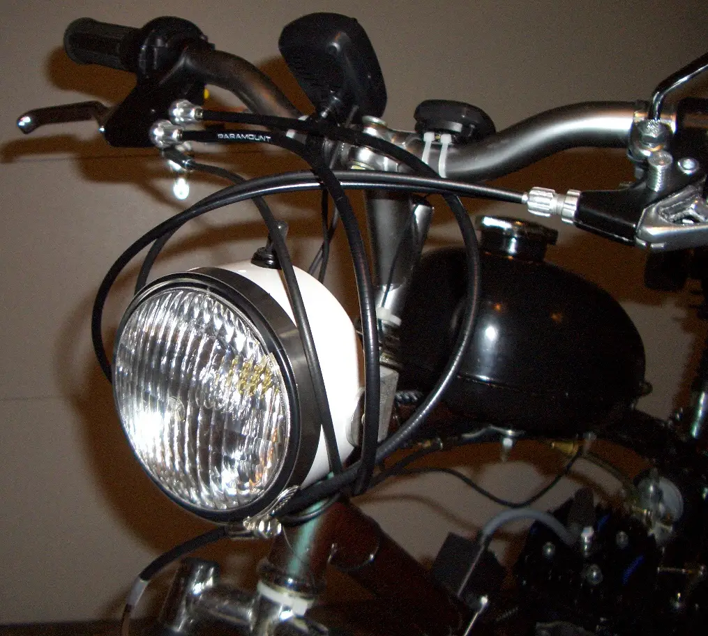

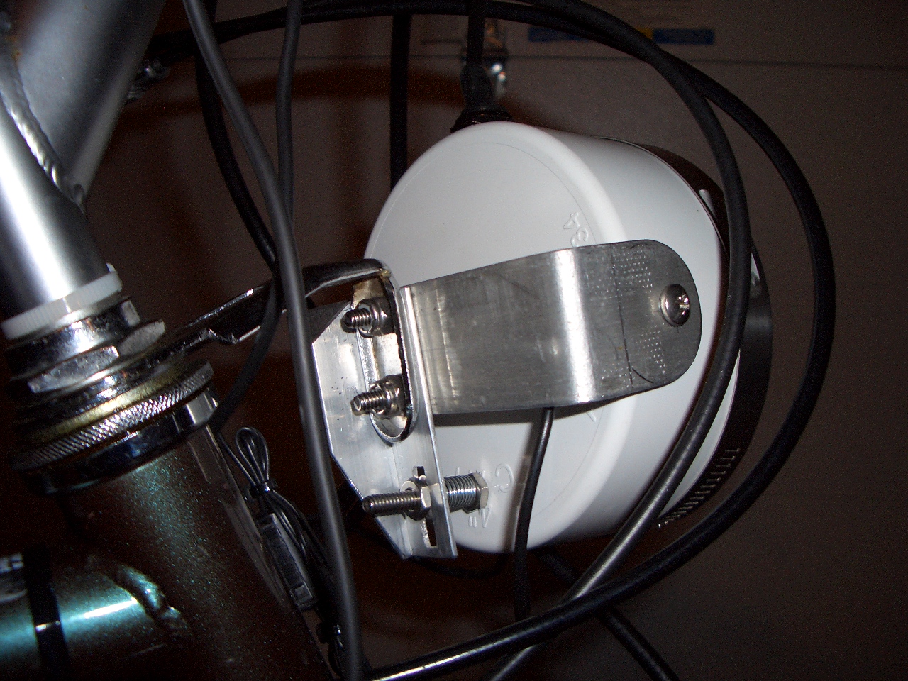

Thanks for all the feedback. For experimenting with different wattage bulbs, I’ve built a headlight out of a 4” dia., Schedule 20 PVC cap, some scrap aluminum, and a 12VDC, 11 Watt landscaping flood light (photos attached). I like the look of a larger headlight – I think other motorists will see it better as well.
The flood light I’m experimenting with now makes a rectangular beam that is about 20 deg. wide by 3 deg. high (see photos). I don’t know if its brightness is adequate for night driving because it’s raining here and I haven’t been able to go for a ride to test it. But, I like the pattern of light it projects.

Good looking light! A little big for me personally but really well done man, nice work.

Wow! That's a very innovative headlight for sure. I like the custom
made adjustment screw on the bottom too. Great job, I agree with you
about being seen by 4 wheelers for safety. Now you need to consider
putting a front drum or disc brake setup on it.

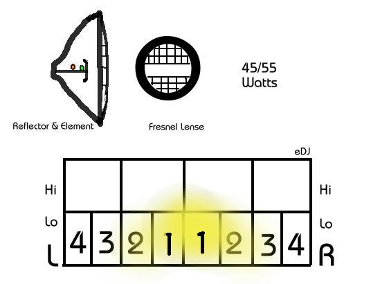

Is this light going to use a fresnel lense ? I mean a lense like a sealedbeam headlamp
on a car or motorcycle or will it be like a flashlight with a clear glass lense.
The light I'm working on will probably work more like a spotlight than a controlled
lumination light as it will just have a glass disk for a lense. I've been looking for
a small motorcycle or motorscooter headlight lense about 3 inches in diameter
to mount ahead of my bulb. It will make some difference when it goes thru that
fresnel.
When you look at all the little lines in a headlight lense and wonder what or why they
are there, these are like small magnifying glasses that direct the beam and intensity
of it. If the lamp has a hi or lo setting it will change the lighting dispersement. You can
measure the light on a wall with a meter to determine the lumens that fall on a graph
if you can find a large white wall. (the yellow shows the approximate single power headlamp
pattern) The high low beam of auto headlamps or motorcycles may be 45/55 watts
but in this case the lamp may be significantly less.
But if you're only using the one intensity of bulb the curve of the reflector and fresnel lense
will determine the dispersement over the path in front of you. The graph below shows
how this stuff is measured. The power of the single bulb may determine whether your lamp
is seen as high or low beam. If you are riding less than 30 mph you really won't need
a hi beam.
