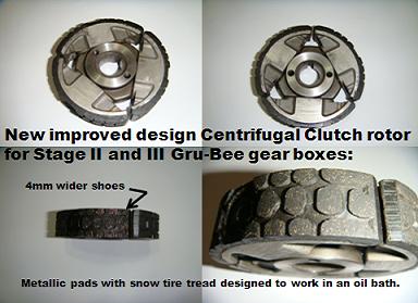

I heard from Don Grubee that he will have a new design CC coming in about a month. It can retrofit the old design. New design rotor pads will have tread grooves and have a metalic base to grab bell drum better and not slip designed to run in an oil bath which will be much better for the gears to get constant lube with no clutch slip. So be sure to nag Bicycle-Engines.com so he gets some in when there available.

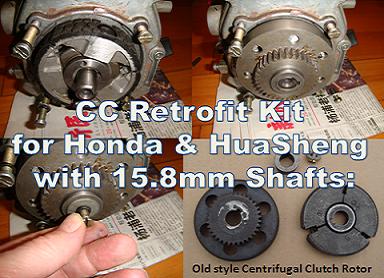

Dan: Don Grubee said he will have them in a month but I'm not sure if Jeremy at bird dog will be getting them right away. I haven't heard back. I did send him a message enquireing about them. I couldn't tell from the pictures if they have a garter spring or not maybe someone who is more formiliar with clutches has seen this design and knows. I also asked about a bearing design for the racer and bell fit together and he said it wouldn't be feasable and retrofit the the current gearbox design.
I drilled the 9 holes in my clutch spring groove and the chattering went away.

By the way dan I did try to look into garter springs to see if there are different ones rated to open up at different rpm's but did'nt find anything locally. I think there are some companies on line that you could find that deal in a greater variety of strengths and desiggns but you would have do do some hunting to get the right step up to find the sweet spot for the honda. I just went with drilling out the 9 holes in the thin part of the clutch and that seemed to remedy it. I'll be getting the wet clutch pads soon as Jeremy gets them so I'm just gonna ride these ones out till then.

I noticed that in the photo on bicycle-engines.com now that you mention it. The replacement ones must be different. If you notice in the photo's of the new one compared to the old one that I attached earlier, they don't have any predrilled holes. Hopefully your new one won't open at idle. I still haven't figured out what holds the new design together if you look close in the center of one of the three sections there looks like a hole with some type of fastener under the surface maybe a allen head or something. Maybe the tension is even adjustable on the new one.
