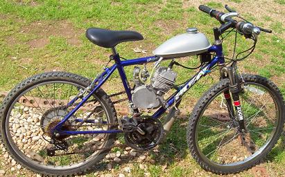

Default Re: New to the board, new mb owner, modifications
First: welcome to the forum
Second: I live in SC. and I have the 54t sprocket installed on a 24" mountain bike along with the 80cc. and I haven't done the intake or the exhaust mods yet but I can say the 54t gives a nice balance for both torque and speed for the bigger guys I weigh around 300 and I do 40mph. on the flatland. Another thing you might also want to check into a boost bottle it might just give you that little extra your looking for.
Hope it helps.

Dag, on an "80cc" 2 stroke with a 54T rear sprocket, your getting 40 MPH? I have to ask, you are saying this is due to a boost bottle? I have never tried one as they were widely thought to be no good. Just asking here.

Sorry I confused you No I don't have a boost bottle on my bike but from what I've seen they appear to have an effect I could be wrong. My bike is a 24" Huffy mountain bike I had for years. I have had my motor mounted for about 2 months now and I love this thing I am looking for "Hop ups" or Mods to improve the performance. I have nowhere near the amount knowledge of these motobikes many others have here but with the gear being my first I just thought I could shed some light. Sorry if I gave the wrong impression.

if you are looking for a silencer sick bike parts sells one also welcome to the forum will love tosee pics if you can
