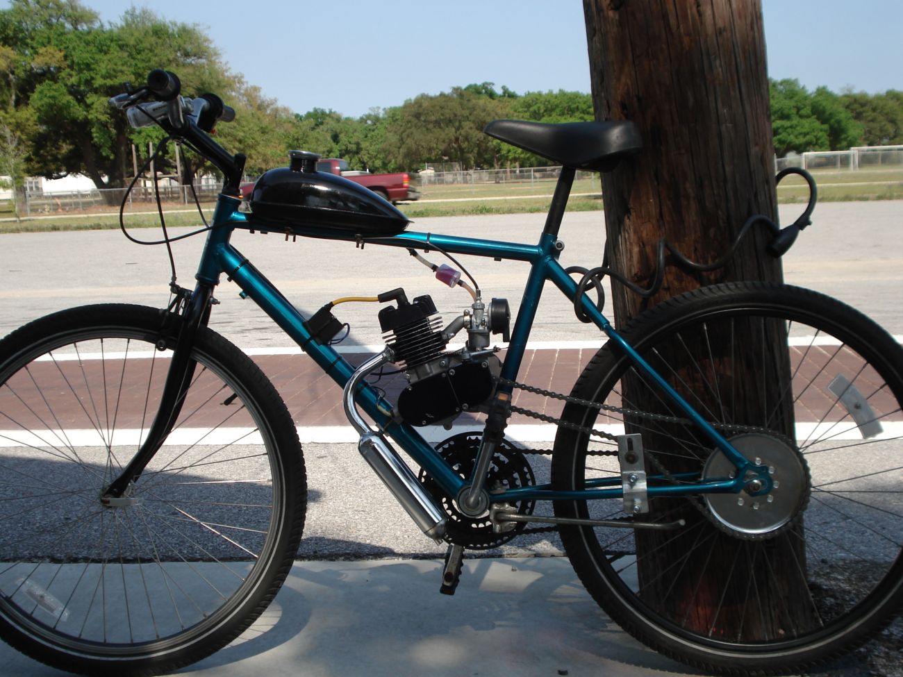

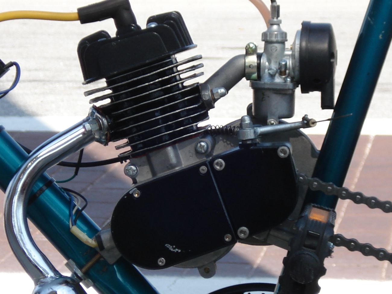

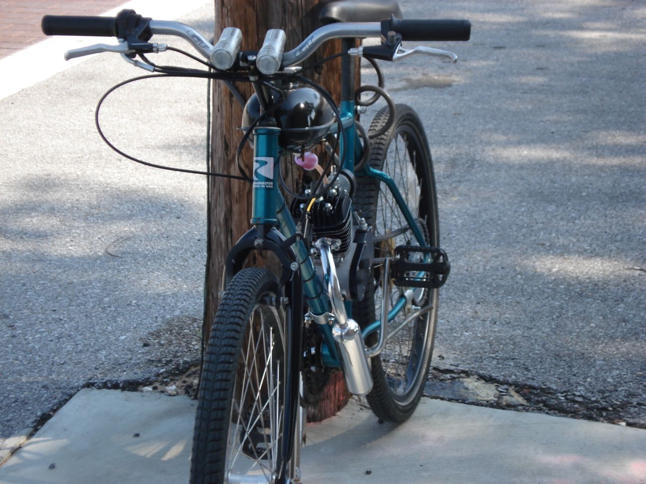

My newest build minus the new seat, handle bars and suspension forks.

very clean and simple just the way I like em. But you are missing your spring on the throttle cable, and it looks just a bit to tight from your first tie strap to the throttle body itself. Plus you may want to get that muffler strapped to something before a couple good pot holes knock your mounting bolts off.
enjoy your new build
