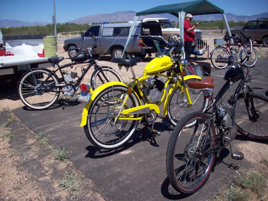

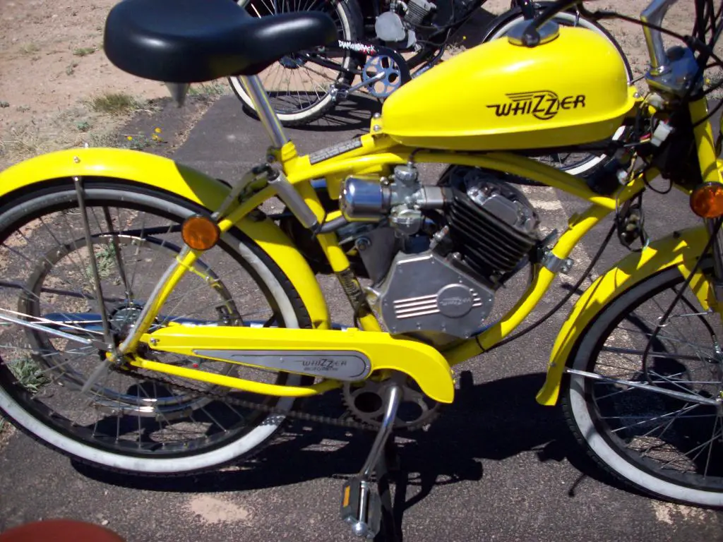

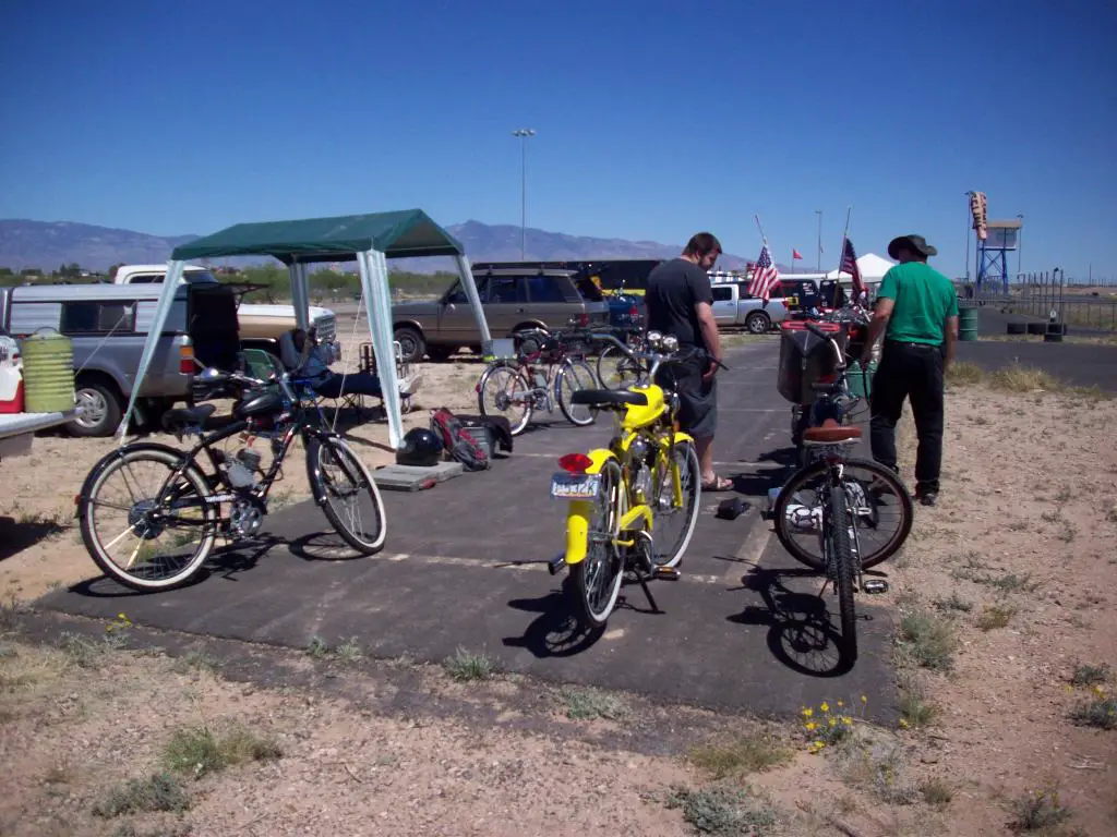

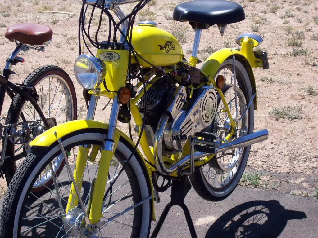

ID:	7590   Click image for larger version
ID:	7591   Click image for larger version
ID:	7592   Click image for larger version
ID:	7593   Click image for larger version
