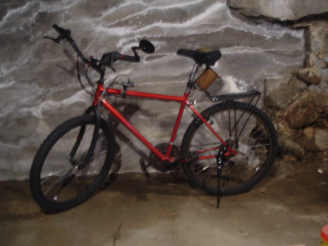

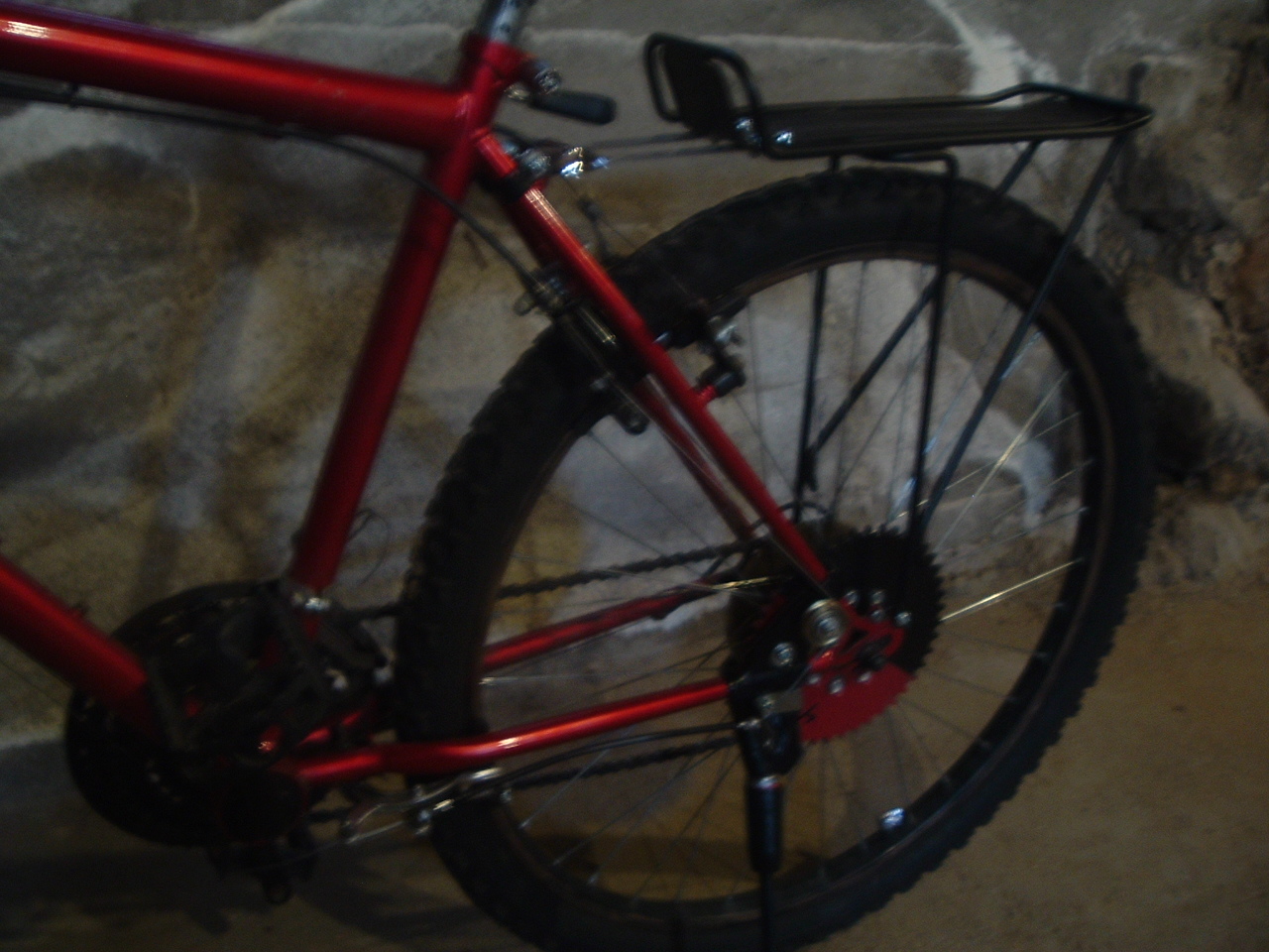

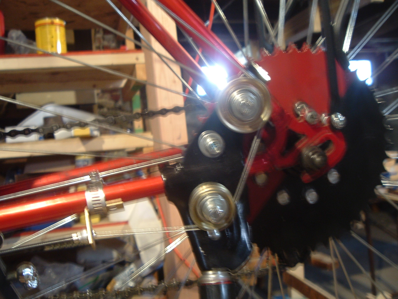

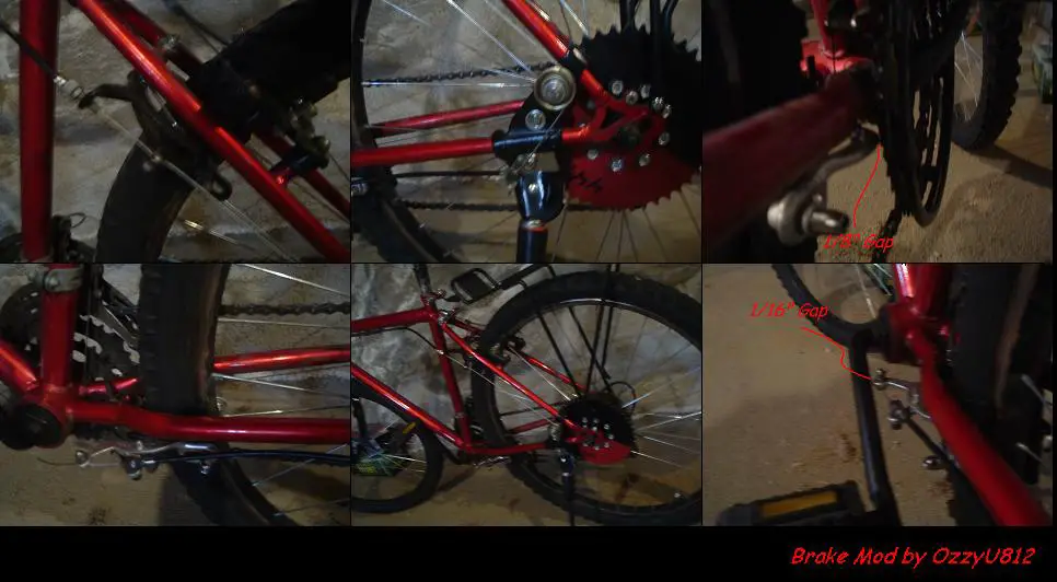

I don't know quite where to start. I'm in the middle of my DAX 80 (70) build. I don't like front brakes. I wanted to run dual rears as I have been. I had a cantilever, stock and added a caliper near it, left lever for one and right for the other. I also didn't want to have a brake & clutch lever on the left. But I haven't ordered a Dual Pull Brake Lever yet. I did see a pic a while back where Ghost had converted a single pull into a dual pull. But I didn't have the materials to do it. Someone had left and old caliper brake on the bike rack right above my tire. Like they was saying, here ya go, you need a front brake. As a kid I had put the brake caliper where the kickstand goes. I saw the frayed wire form my existing caliper, I had just finished a pre-install of the Large Filipino clutch pull mod.(for more info search "Clutch cable better mounting yea!" at place that shall not be named) Then the AH-HA moment! But are the cables that long? I had a new set of Wally World cables checked for length and unbelievably they're long enough! So robbed some nuts and bolts I have got for the kit and mounted the pulley and gifted caliper, ran the long new wire though exiting cable though brake #1 round the pulley to brake #2. Looked at it said that ain't right. OH, it needs a cable jacket and "L" bracket. Cable I got,but I didn't have a "L" bracket. I have a strap with holes in it that was going to from the top of the chain tensioner to the frame for added security. I worked it back and forth at the 3rd hole til it broke and bent it between 1st & 2nd. There was my "L" bracket! Which I will replace when I go to the hardware store to get all the stuff I stole from the kit. It seems to work really good! Feels like there is only one brake! Having the pulley adds leverage. There is a bit of a friction point right at the "L" bracket. Which could break the cable in time. I'll either get a larger pulley or move the "L" bracket to the bolt just below the pulley. There is a little tweeking to do on it, but, I couldn't wait to get some pics and post this.
Now, in a way I'm back where I started. Because I still have 2 break levers. I'll most likely just put the one for the cantilever in some odd spot on the bars to avoid taking it apart and losing parts. Until I get a dual pull break lever. Then it will have 3 breaks on one brake lever! I do realize that this adds no additional tire to road breaking surface, and there is most likely a point where break pad to rims surface does no further good. Since I'm not an engineer, I have no way to figure that out. I'll just go way beyond that point! Besides it looks so cool!

The majority of your stopping power comes from a front brake. I can see the "law of diminishing returns" coming into effect with your current braking system.
I would never want to be without front brakes myself but over the years I have learned how to use them to their full potential without going over the front bars and they have saved me many times.

I have been using the front brake on my E-Zip. It has a suspension fork which is more forgiving. This one does not have a suspension fork yet. I not worried by any means of the over the bars flip. I don't think that would even be possible without conscience effort to do so. But I have had the front rim lock up before the rear and caused some squirrely sliding on a several non-motorized bike without suspension fork at 10 - 15 mph. On a MB going 20 - 30 mph, I want some degree on control and predictability. When I get a suspension fork on there then I'll put a front brake on there.

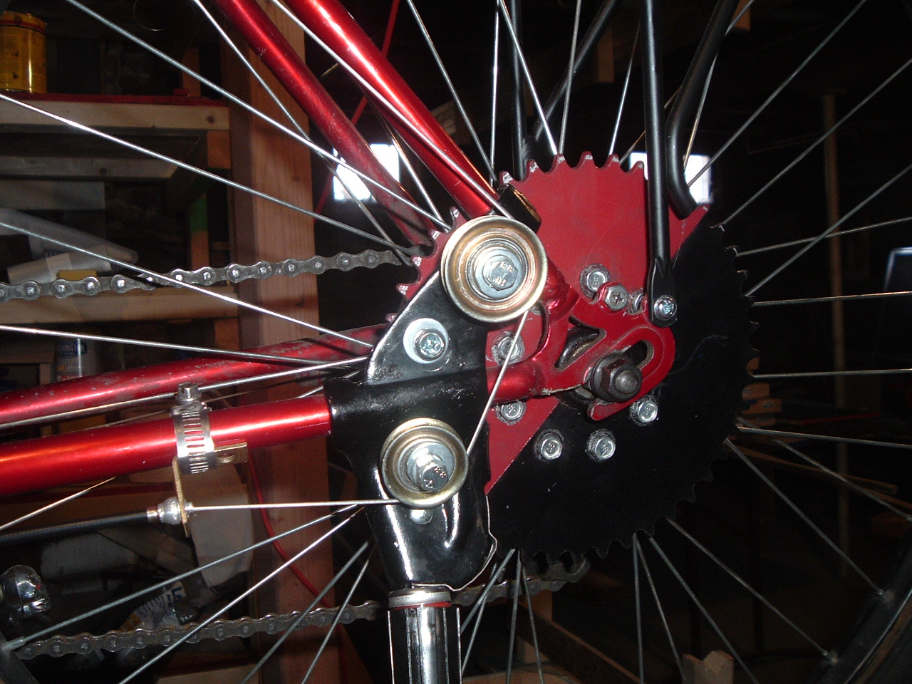

The bike is incomplete, its a work in progress, OK. It will have front brakes AFTER i get suspension forks. In all likely hood a pair of them, just to see i if can do it, for no other reason.
Thanks for the compliments! It just came to me and was a spur of the moment thing.
Done "final" tweeks. Got to see if the tensoiner interferes. I've only rode it about 3 miles. They seem to work very well. Almost too well. pull a little to hard and it locks up. Not surprising!
