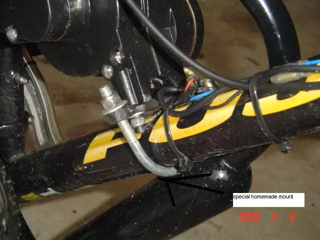

I tried the drill thru method , but it didnt last.
So then I welded a nut on either end of the "universal" mounting bracket and used a u-bolt to finish it off. this method was much stronger

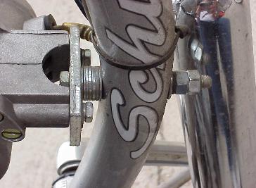

Found a couple of pics. I see that one vendor is now offering the muffler clamp fix.
Other pic was too large. I will edit it into this post in five minutes...
Having probs. Here is the link, just scroll down until you see both ways. You are looking for the "NEW" mount that goes for 13 bucks.
Google Image Result for http://www.keywestpaddlesports.com/120.gif

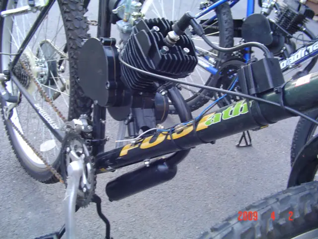

dax's ENGINE_KIT_PARTS_PAGE_4 (thats how mine look but not as purty)
SBP Sick Bike Parts LLC - Performance Parts for Your Motorized Bicycle
