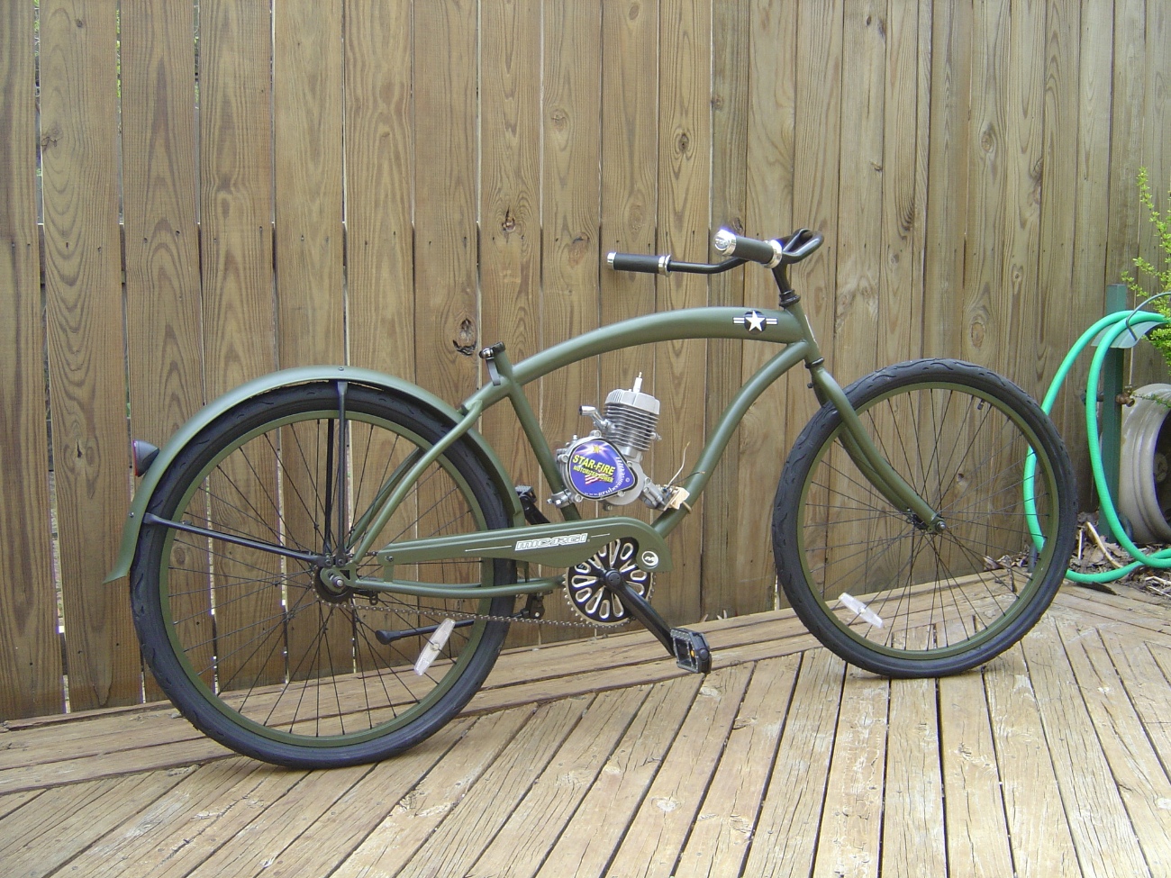

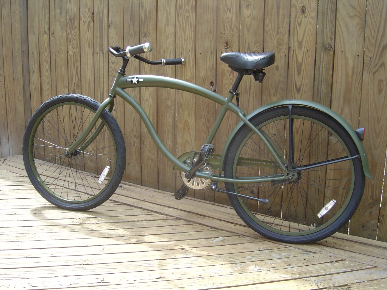

Hi everyone - I'm building my first 48cc motorized bicycle from a kit, and I just discovered this amazing forum a couple of days ago.
I bought the engine kit and the bike (a Micargi beach cruiser) from BikeBerry, and they both arrived in less than a week and it seems like all the parts are there. This build will probably take me a while and I'm slightly concerned about the end result, because I'm one of those who tends to be way better at taking things apart than putting them back together... Nonetheless, I'm totally captivated by the thought of riding around on a motorized bicycle, so here we go.
I've attached a couple of pictures of the bike, pre-engine installation (I haven't even ridden it around the block yet). I think it has a cool WWII look to it, and I'm going to try to build on that look as the project moves on.
