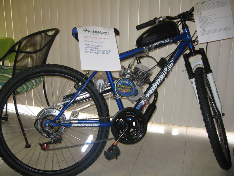

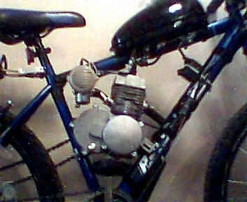

26" roadmaster mountain bike $20
48cc dual start starfire gt-2 grubee engine kit 44T sprocket $186 gasbike.net
top speed 31mph (i try to stay around 20mph)
carb mounted on right side
basket on front
gas used 1liter

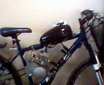

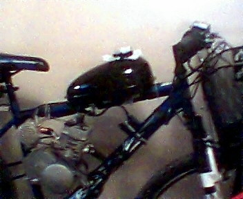

I just did a Roadmaster install. It was a real pain. Wish I would have read this thread before building it. It did turn out sweet though. I had to grind out the engine mounts so it would set lower in the v frame. If I had the right tools to grind out the brackets properly, I would make this a regular build.
Tony
tony i got your picture posted for you.
caribbeancruiser
