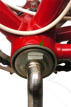

Well I just got a jack shaft and have run into my first problem. Installing the cranks, I took my one piece off the bike, but I can't seem too take the parts attached too the bicycle frame to add in the new bottom bracket.
Do they thread on, should I just beat the carp out them with a hammer, blow torch and dynamite?

Never mind, just needed a bigger hammer. I'm sure I'll have more questions though as I go along.

If you think about it, those bearings get a huge workout with the jackshaft. That thing is spinning 100 % of the time now.
Others may know better, but I thought it was very important to drill a small hole into the bottom of the bracket and I wound a grease nipple into it. It took three minutes and now I can keep grease on the bearings. It's easy if it's apart.

While filling the BB with grease is not necessarily a bad idea - think about it. If your spindle was turning in the bearings 24/7, would not the cranks 'n pedals be turning also?

After thinking about it, I could be wrong Pablo. I was thinking that it is spinning any time the motor, No wait, I am correct to say that the crank is always spinning if you are running the motor.
Without the jackshaft kit, the engine drives the rear wheel and the crank only spins if you peddle. It's also correct to say that the freewheel is also always spinning.
I also plan to put a grease nipple in my rear rim. I find that once a month I have to tighten up my bearings as I get too much play.The grease is always gone as well. I'm at that point again, if I put on my brakes, I can see the brake pad move the rim over to the side. These wheels were not made to go 40 miles an hour for hours at a time.
