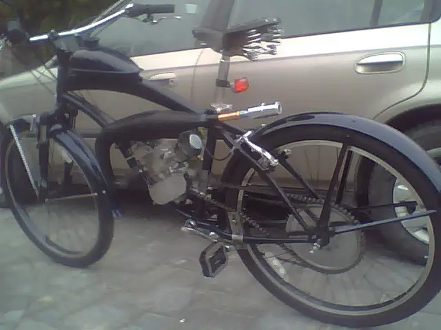

With a 56 tooth sprocket 50cc iam getting 150 mpg --of course iam 215 lbs but it is a canadian gallon one fifth larger-- i also carry gear because i travel mostly back gravel roads--tuned pipe big carb
