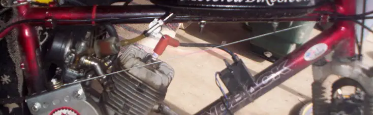

It's just me but I had my clutch cable break twice at the lever before I took a look at the
stock design. I noticed there's a kink from the cable mount to the clutch arm later designing that
roller. It made a difference in clutch pull by 1/3 and no snapped cables.
Later on I eliminated the cable mount from the engine entirely. I even retained the same cable when I transferred it over to MOOP2
Here's that pic with ads removed. It's the same setup on MOOP2. I used a derailier clamp to keep the cable on the frame. On this pic I used the mount the front derailier cable usually goes when it's just a bike.

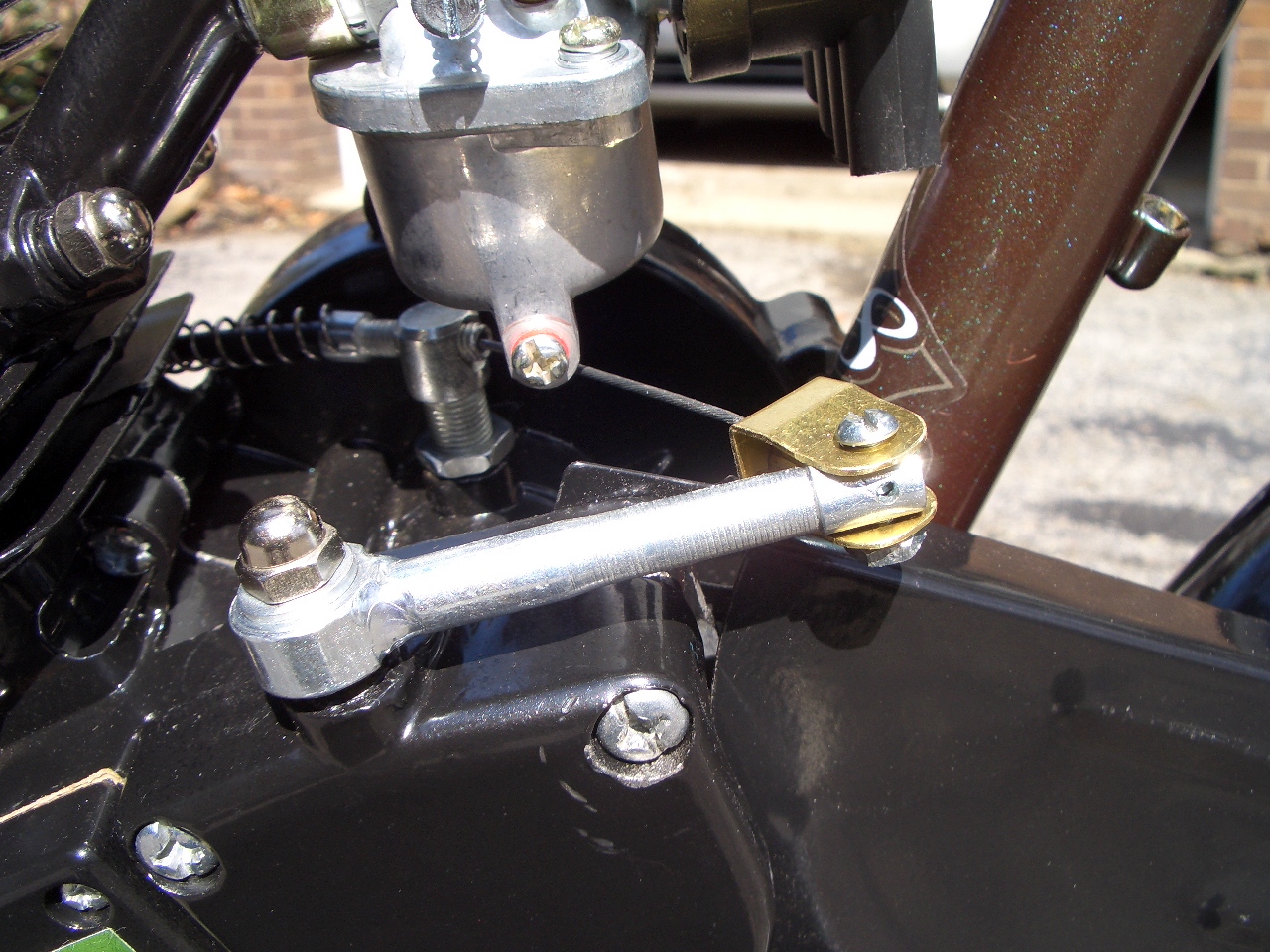

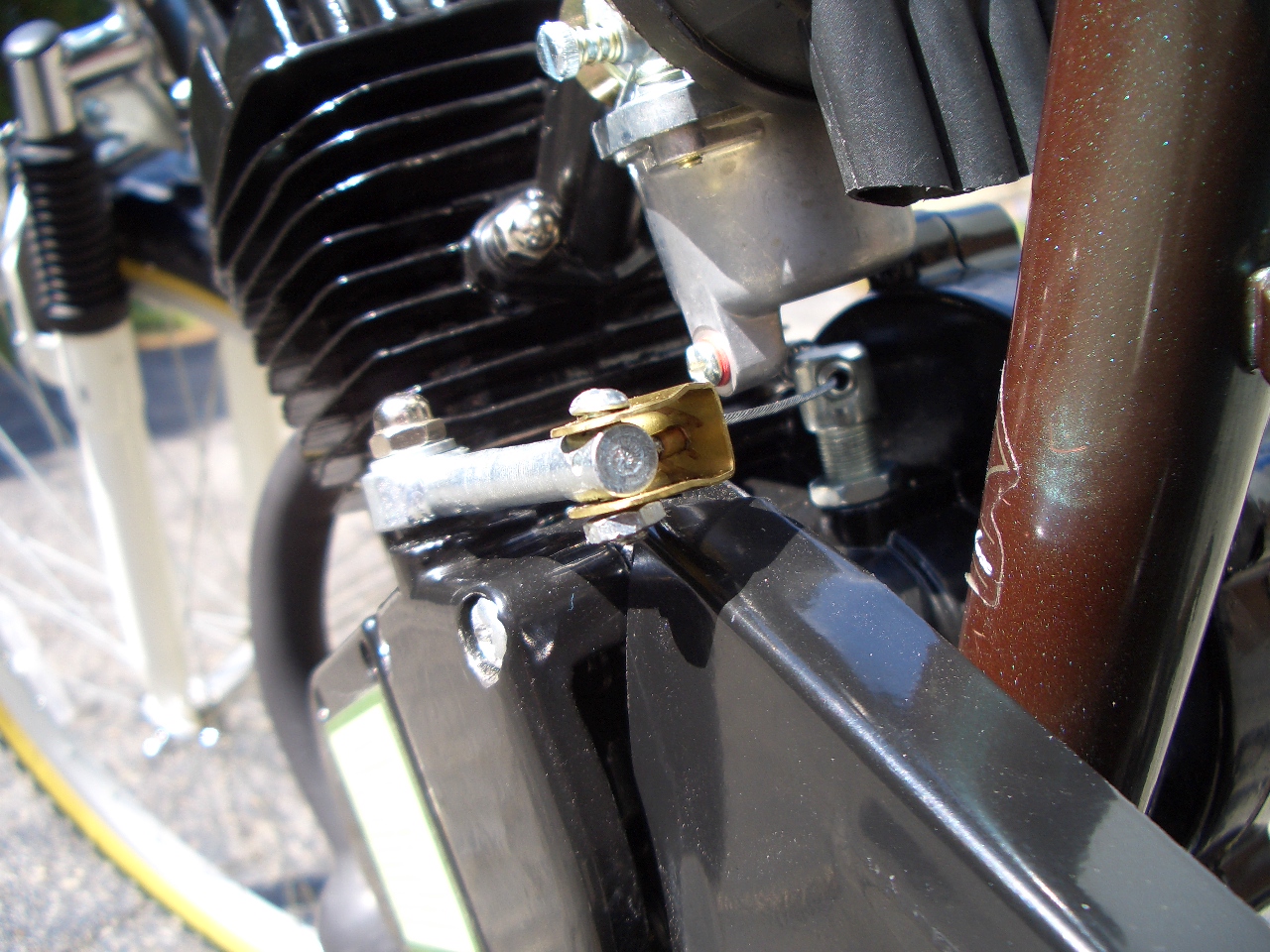

I didn't like the kink in the cable at the clutch arm either when installing my engine. The original setup looked like a bad idea. So, I added a homemade bracket made from brass I got at the hobby shop to hold the end of the cable at the end of the clutch arm. The bracket is held onto the clutch arm with a screw and nut. I deformed the threads at the end of the screw to keep the nut on. I also had to solder a cable stop onto the cable. My current setup eliminates the kink and and lets the clutch cable pull straight on the end of the clutch arm. The clutch cable should last longer. See attached photos. When the current cable does break, I’ll replace it with heavy duty BMX cable, which looks at least 1.5 times the diameter of the stock cable.
