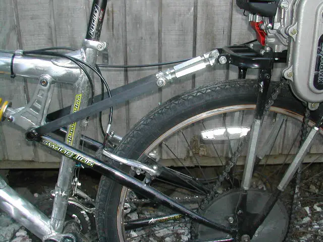

No way I'd ever go crummy two-stroke-joke with ridiculous carb setup again. So I got a 4-stroke rear mount kit from bicycle-engines.com and put it on a cheap Craigslist full-suspender in hopes of reducing pinch flats if the rear wheel could "give" a little.

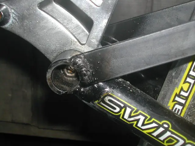

I laughed at the idea of having the entire heavy assembly held on solely by the rear axle. I've had enough flats and suffered with tire removal, but to have a flopping engine too?!?! So I grooved and welded the brackets to the rear drop-outs so the tire could come right out and the engine assembly could remain unchanged. Being rear suspended, I couldn't mount the front turnbuckles to the seatpost, so I welded in a length of flat steel to the front pivot of swing arm.
ID:	7131   Click image for larger version

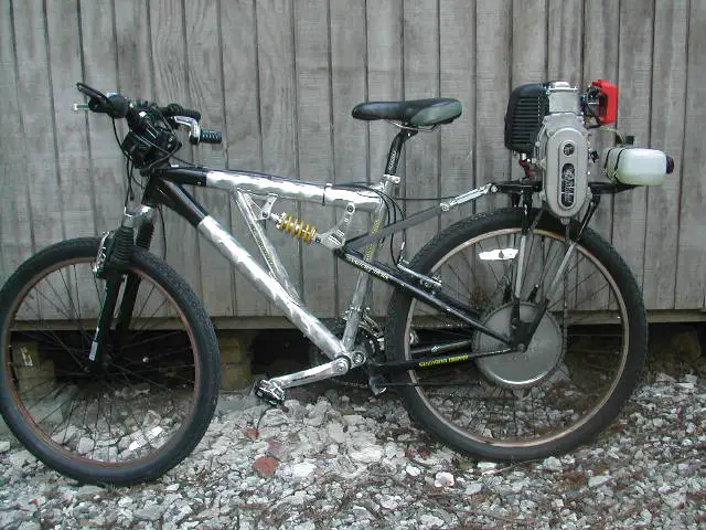

I guess I can't post three pics at once, so here's the main view

That is a sweet ride, glad you are back on the Iron Horse.
