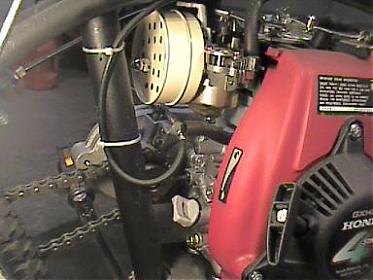

Here's my "high tech" Honda GXH50 airbox...of course I was going for "retro", not performance, but I'll take what I can get. Of course I also had to replace the original airbox because it would not fit.
...and in the spirit of retro, that garish red cover color will be going away soon along with all the stickers- body color, same as the filter housing.

Nice...that's a major improvement on the stock airbox. I'm a fan of the retro look as well.
Is your airbox from one of the small russian engines? I removed the red cowling from my engine, and it looks much better...less like a lawn mower:D

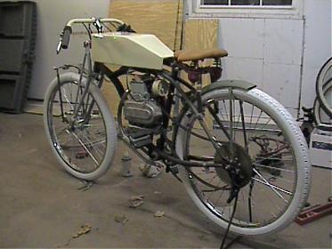

I don't want to get away from the air box mod issue, but since you asked, I used the standard tank and fabricated a fiberglass cover to mimic a more vintage look.
I made a form out of foam board, glued fleece on (in the future I would use fiberglass cloth because the fleece required a lot of smoothing), brush on resin, sanded, brushed on more resin, sanded, then filled, primed and painted- it sounds easier than it was. The tank is secured with polyurethane adhesive and polurethane foam.
