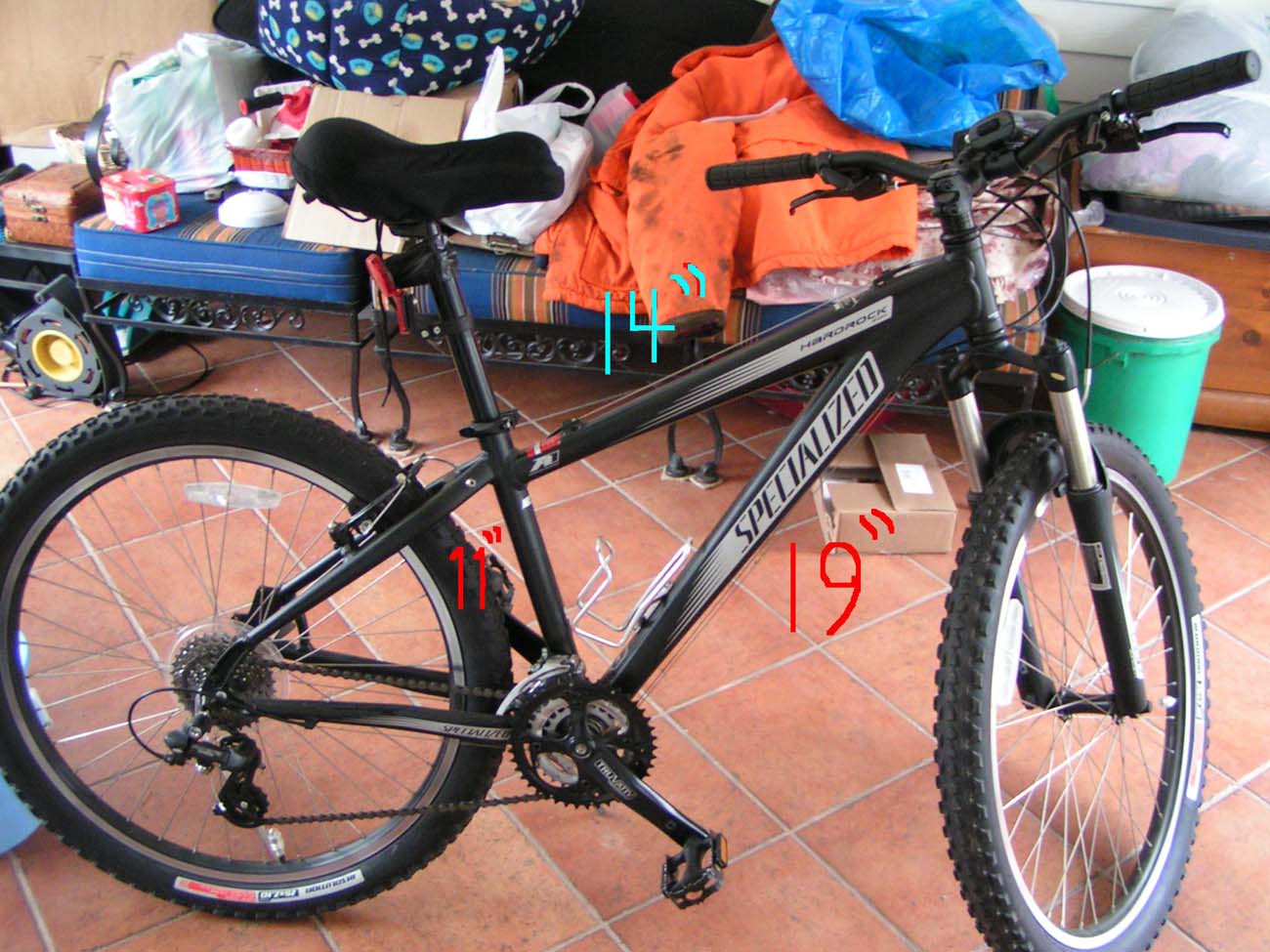

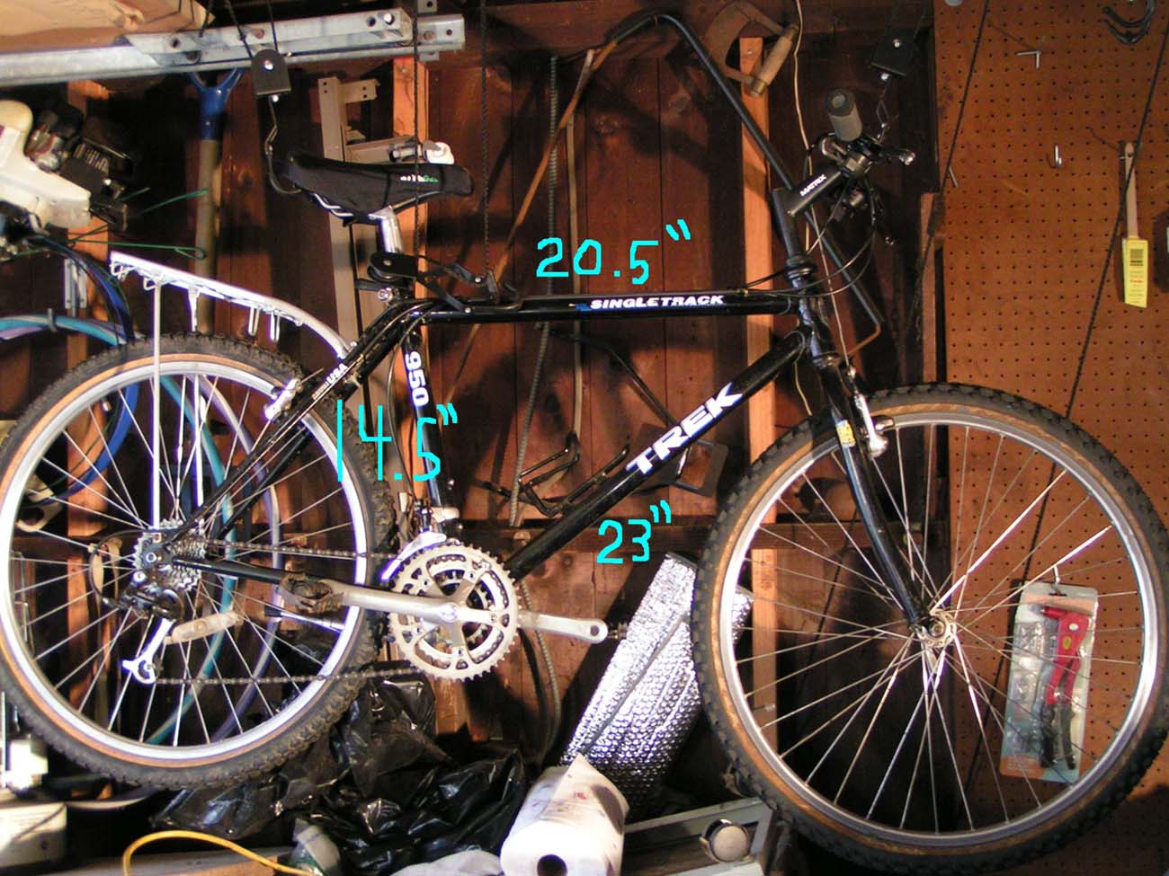

This is my first post on the Forum here. I'm looking to get a kit for one of my bikes and I wanted some expert advice. First off, I have two bikes, and I dont really know which one to use. The first is a pretty new Hardrock Specialized mountain bike, and the other is a Trek Singletrack which is pretty old but still a good bike. Basically what I need to know is which bike would be better given the dimensions of their frames (dimensions on pictures), as well as what would be the optimal motor for each, rear mounted or in frame. I was leaning towards the hardrock because its new and because it has shocks which would help for smooth riding, but I thought that the frame might be too small to fit a motor in it.

The motor would fit the Trek more easily, check this thread for the dimensions need to mount the center frame 2-stroke (post #14)

Unless you're thinking of going with a rack mount or friction drive, the Trek would be a much better choice. In fact, I don't think you'd be able to get a in-frame 2 stroke on the Hardrock without some major surgery and you probably don't want to approach that bike with a hacksaw or cutting torch. I like the looks of the Trek better too. It will make a good looking motorbike. Just my opinion however. Now with that said, here's an idea: Put a 2 stroke on the Trek and then buy a rack mount Titan from Dax for the Hardrock...best of both worlds.

I agree with the others especially for a first build the Trek is easiest. I used a similar bike for my first build and will continue to twaek it until I feel comfortable enough to complete the OCC Chopper I picked up this past weekend for $50!!!

Welcome to the forum twip. Those are both good looking bike there but as others hav said defnitly use the TREK. I would reccomend for your 1st build use a 48cc two stroke frame mounted engine.
