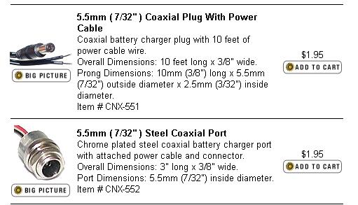

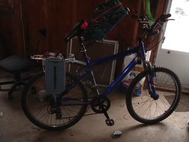

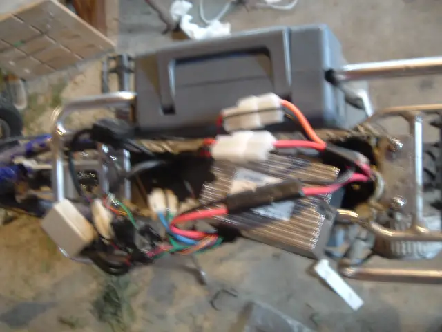

Just looking at the wire gauge's. I would have to say there is no 12v source in the in there. There is only 10 gauge for the 24v battery pack and and 20+ gauge for miscellaneous in there. You could put a plug in the side of your battery pack connected to one of the batteries. But that would case one of the batteries to have less of a charge. That could be an issue, I know know if it would do any harm or not. You could however hook both batteries to the plug and run 24v safely. If you find that having an imbalanced charge could cause a problem. Of course, doing so would greatly reduce an already poor range. I don't know if the connectors in the pic are rated for that type of application, they are for chargers. I just had the pic and used an as a visual aide. Do you really want to open the wiring up? I think the best thing is to get a Bell headlight and rechargeable batteries. I had a Schwinn light and surprisingly it was not of the quality I expected from Schwinn. I had the wiring open anyhow to run a couple of batteries in the basket to desalinate them. I'm waiting on jumpers to do so. While I have the wiring out I'm going to try to figure what is the PAS and Kill switch and disconnect them. I can't run the Kill switch now with the Rapid Fire's now anyway. The PAS is just an annoyance. But I digress........

I don't know what's happening with the pics? Here's the main ones I wanted to show you>
