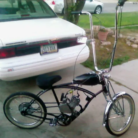

I have 20" wheels on my 26" old schwinn frame. With the standard kit, i think I've gotten it up to 15-20 mph. I don't have a speedo, but the cars in my nieghborhood don't seem to pass me too fast. The spped limit is 25. That's my white Grand Marquis I'm not allowed to drive anymore.

thats a kool bike
