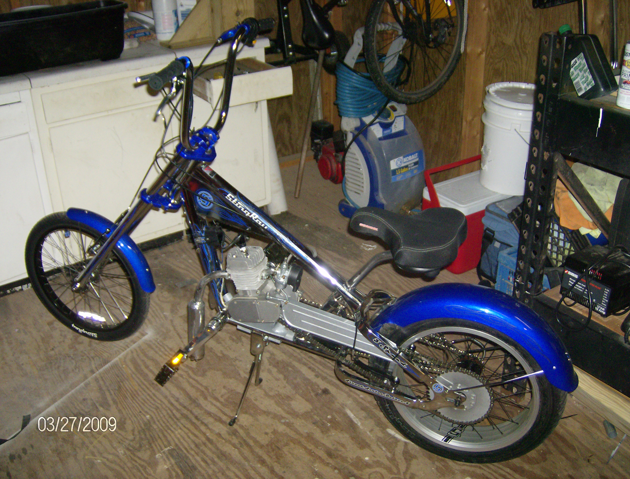

hey pablo. I checked the plug today after a ride and it looks good to me. its a little gray,(just a little) it isn't oily or black.actually i was supprised how clean it was.Is this normal or shoould it be oily.One thing is Im not used to riding a 20inch bike. Everyone I've ever built was a 26 inch. this thing is slow! here's a picture of it

Nice looking bike!
Not a bad idea, and it sounds like it's not too rich. It could be a fuel delivery issue, so check the cap, fuel valve, fuel filter, float valve, main jet......
