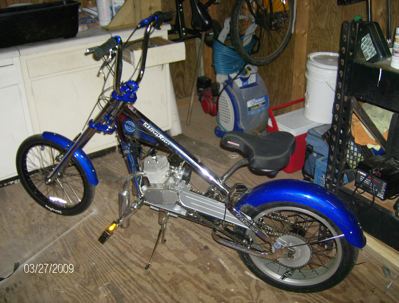

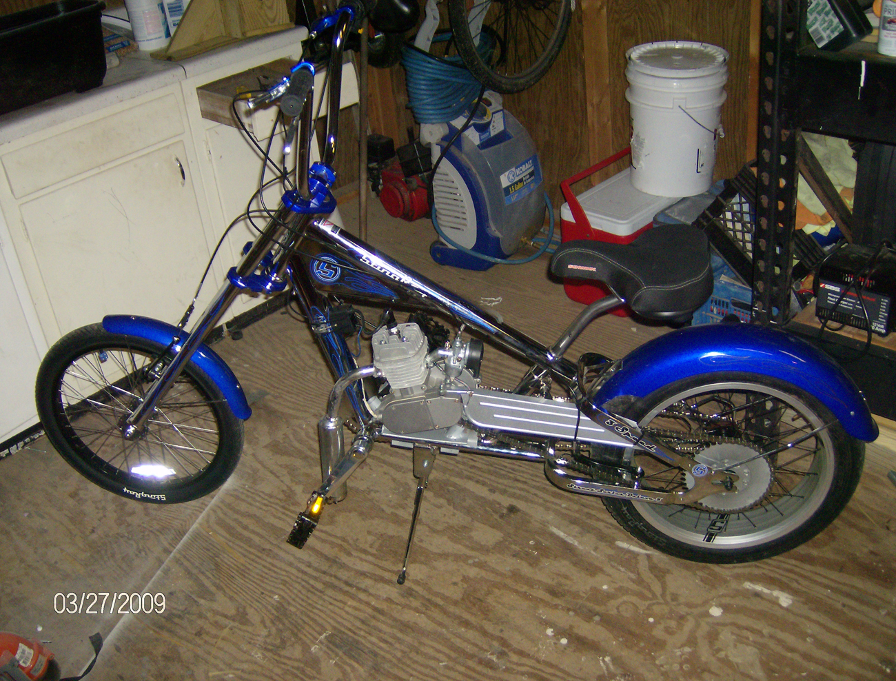

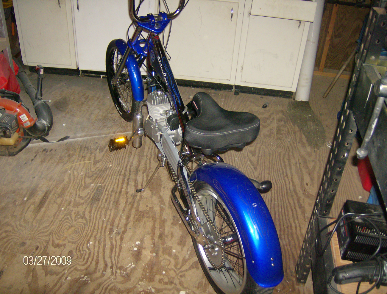

If you want a challenging project ...do an OCC STINGRAY.If I had a nickel for everytime I loosened and tightented the bolts on the mount I would have been rich in the first hour!(LOL) Anyways, it was worth every minute. Thanks to DAX for the kit and Barry (ebay) for the mount.I just ordered my custom exhaust from barry this morning.I used the stock sprocket and it isn't very fast,but all I have to do is roll it off with my foot and let the clutch out and away my big azz goes.This is not a bike that I need to go fast ...just cruise around and let everyone stare.Anyways, maybe later I will put the three speed hub wheel on it. I wish someone had a jackshaft for these bikes so I could incorporate that 3 speed.That would be awsome to reach back and change gears.Here are some pictures with the factory exhaust and the tank is getting a custom paint job.

toker you can get a smaller sprocket and you will go a lot faster.
