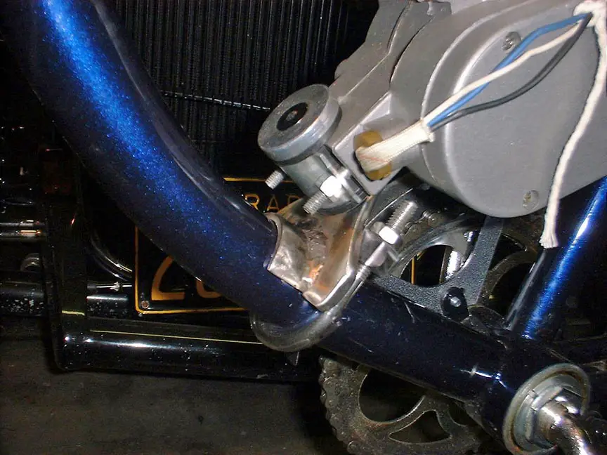

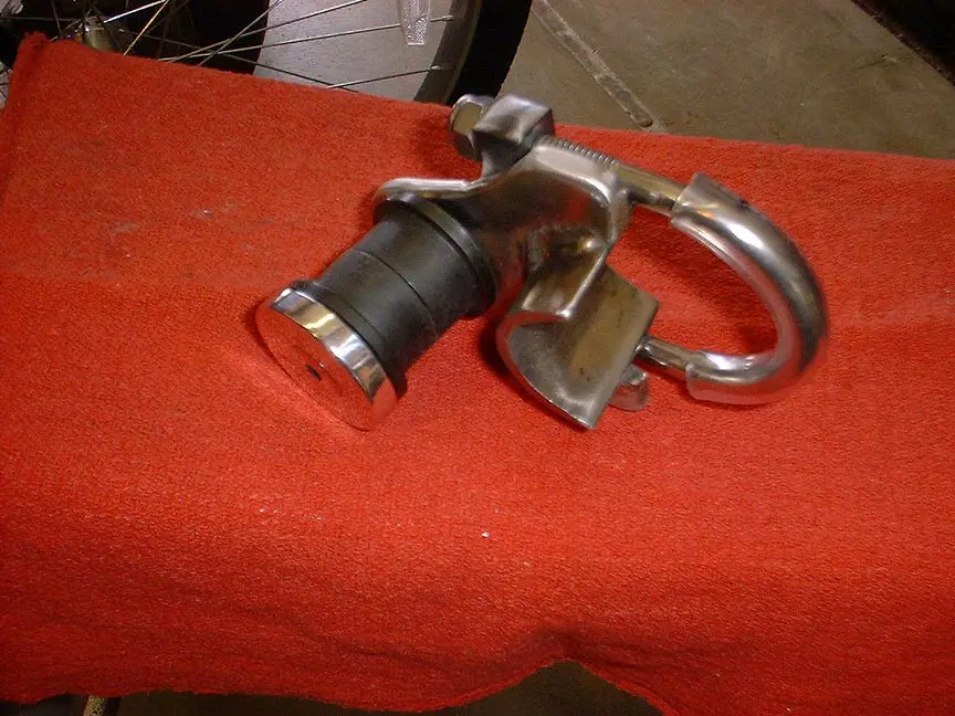

You didn't say what engine you're using but if it is a Chinese 2 stroke, in-frame I'm trying to picture how the stock engine mounts are working on a Jaguar frame. Because of the diameter and curvature of the down tube the front mount will require some form of fabrication to fit. Most cruiser style frames will not allow a bolt-in installation and need some work. The 2 strokes are designed to fit 'V' frame bikes. If your engine, assuming it is a 2 stroke, fits the Jag frame you have something unique. Did you drill the frame and use the kit mount? If so, is it possible you failed to center the hole? If possible please post a picture of your bike and the engine mounts so we can offer more help. I'll attach a picture of the front mount I built for my Jag.

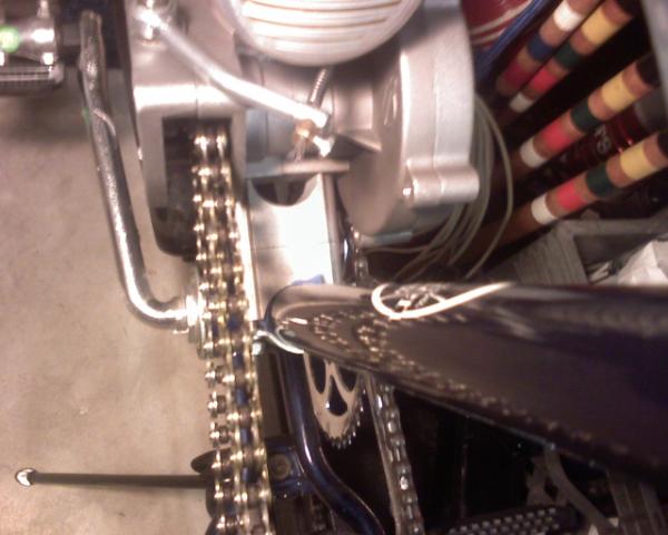

WOW! Can I get one of those...? I am dreaming... I love my new MB. I don't want to show the entire thing yet. As I want to start a thread on my completed MB. But here is my rear mounting setup, I just used the extra one that can in the kit. I wanted a better way to do it; it looks like you did!

Maybe I'm missing something here but I can't understand what you have done. It appears that there were two rear mounting blocks (spacers) in your kit and you have used both of them, stacked them end to end to achieve the reach you need to mount the motor in the frame. I have 3 kits and none of them came with 2 spacer blocks as yours apparently did. We need someone who has run across this to offer some advice. What did you do for the front mount? I know the semi-circular area at the front of your engine will not fit the Jaguar down tube. How is the engine mounted in front? Trying to help you here but need more information.
