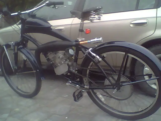

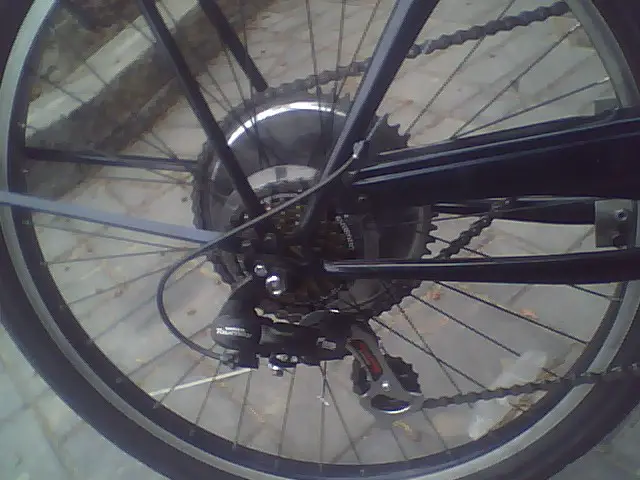

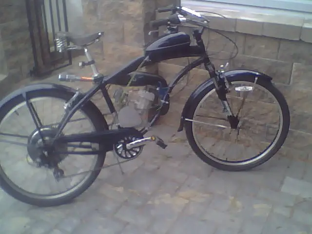

I have lots of hills in our area and mountain trails so i now use a 56 tooth sprocket 80cc tuned pipe big carb
Hi Robin
Will your bike climb any hill with that 56 tooth?
What do you think your top speed is with it?
Your bike and that pipe looks great! Where did you get the pipe? Is it loud?...POPS

i got the tuned pipe from pipeline industries--there is a posted thread "for sale scw tuned pipes" now have 80 cc engine i just mounted so hills iam not sure because having carby problems -50cc it will climb some very steep long hills--also 56 tooth much better for trail riding--you can go much slower -never have truly measured speed i assume 25-30 mph !
