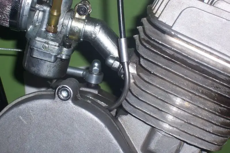

Had to take the nasty bend out of my clutch line, I used a 90* mountain bike brake line. It really helped out with the clutch tightness.

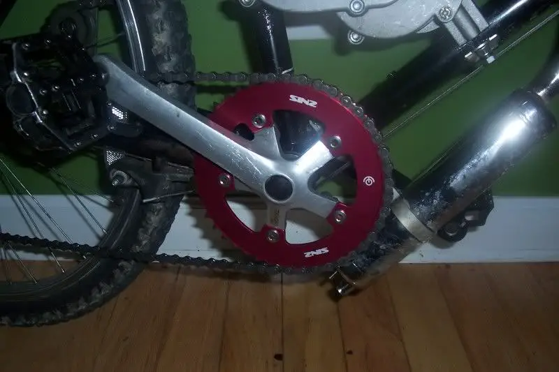

I wanted less pedal and a better consistent speed, so I changed my chainring out for a better one. I went from a 38T to a 43T and It made a big difference.

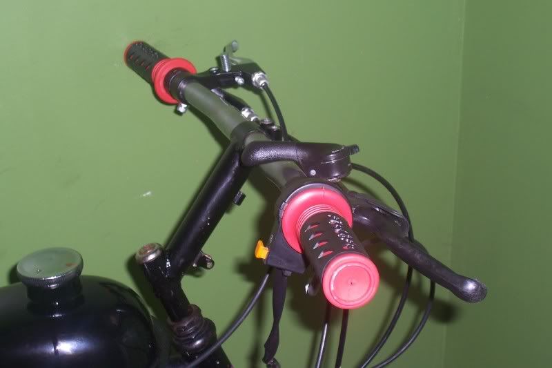

The cheapo grips are outta here, destroyed the left side getting it off, but its ok I got new ones...DIRECT FIT, I had to make zero mods for them to work....

with the grips how did you put the righthand one on with the throttel?

Theyre pocket bike grips, the right side fits like the one that comes with the kit.

nice job its good to see a non-kit grip
