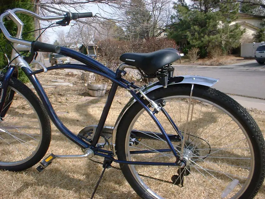

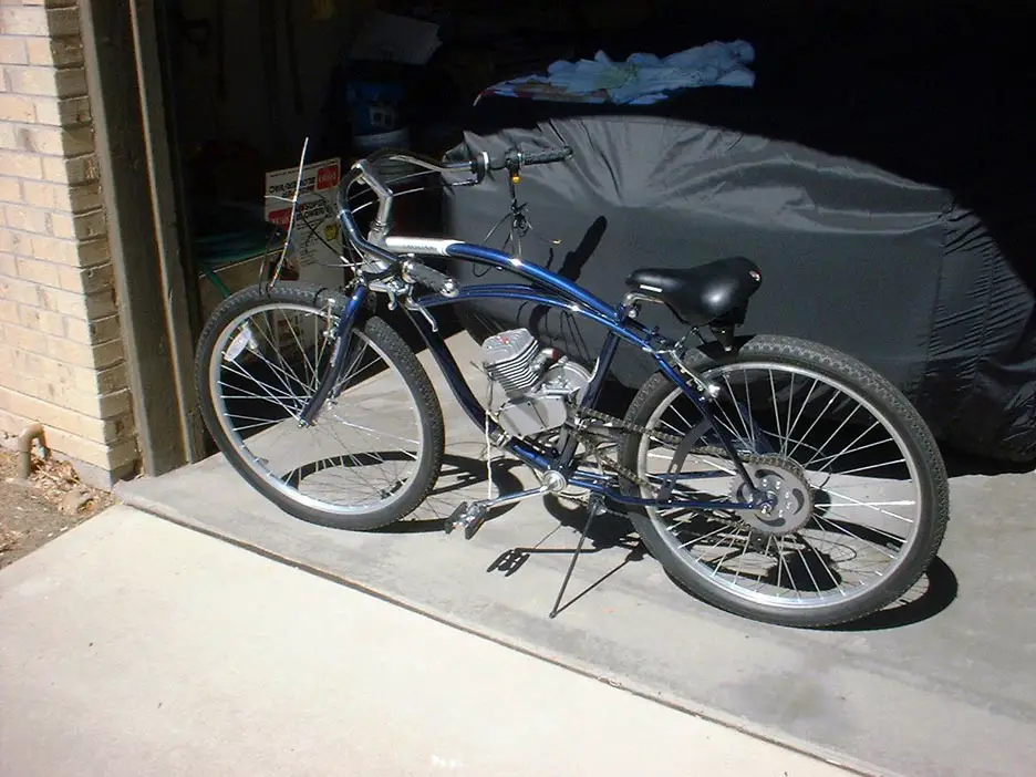

Grouchy,
I'm currently building a Schwinn Jaguar which I've been told is very similiar if not identical to the Point Beach frame. I made my own 'lay-back' seat post from 1" bar stock. The seat end needs to be turned down to 7/8" to accomodate the seat and I gave myself 6" of travel to the rear. My bars are also flipped so I know all about that werird posture stuff. I'll attach a phot of the as yet unfinished Jag so you can get an idea of what the 'lay-back post will look like before you purchase one. Oh, and by the way; I'm the guy who got Dan's fenders.

Oh Man! That is awesome 2Door!! the sprocket, chain tensioner, handlebars, seat... You found a way to make a really cool Board Track Racer like MB/replica for a few hundred bucks. You really have to do a thread. Paint it black and you could sell a bunch of those real fast.
Looking close at her, I can not see a bit of difference between her and a Point Beach. I knew they were close but think you are right and they are identical.

Dan,
Didn't see a business card in the box with the fenders. I hope I didn't pitch it with the box and peanuts they were packed in. Rats!
Your seat post is exactly like the one I made for the Jag. They're a little heavy but not so much as to drag you down. I love the way my Jag sits now; really comfortable with the seat moved back. I'll ship it Tuesday. Let me know what you think. I just painted the fuel tank today, first coat of blue but I need to get the white stripes on it then the bike will be ready for a test run. I'm getting anxious. I've put too much time in this one and concentrated on the asthetics. Hope I didn't screw up.
