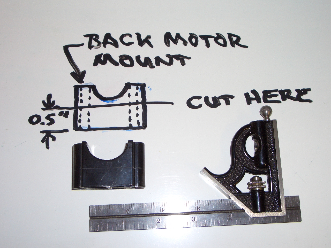

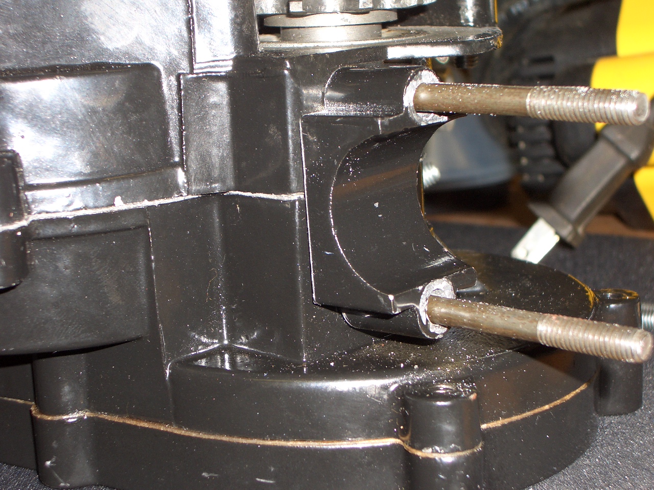

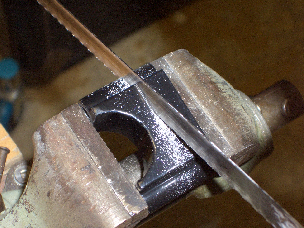

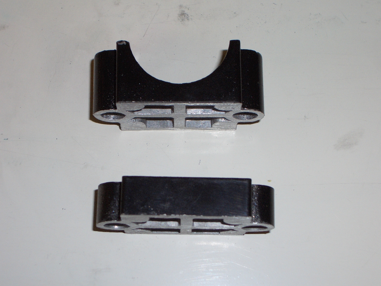

I shortened the rear mount for my engine by cutting about ½ inch off with a hacksaw then cleaning up the cut with a file and sandpaper. Cuts easily and works fine in my application (see pic). The mount may be a little weaker with respect to bending, but it isn’t subjected to that kind of force if the seat tube fits properly like my case.
