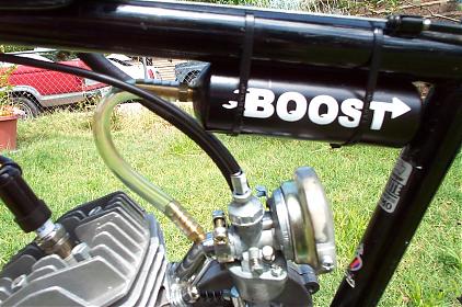

Hello Norman,
New guy here on the forum, but long time motorized bike rider. I just joined the forum a few days ago and have been searching thru pages looking for boost bottle references and here it is.
I have been running a boost bottle on my setup and it works great. I had a couple of other people ride it, that have stock motorized bikes, and they could really tell an increase in power. I got mine from Boost Bottle Industries and they are matched to the 69.x cc that my "80cc" chinese engine volume is at and all I can say it WoW, what a difference. Just sharing my experience of what I have on my bike. I have a youtube video of it here: YouTube - Quarkdude's Boost Bottle Motorized Bike 2008
You can see and hear it run.

how does the boost bottle work? i see on the company's page that they have NOS and the Boost bottles i understand the shot of the NOS going in but how does the boost bottle work? ...just curious

I was just going to go to boost bottle industries website and copy the info you just did. It really does explain how the bootle works. The boost bottle I have on my bike always gets questioned, asking if I have nitrous and I just laugh and then explain what it does and they ususally go ---Ohh. It really works well, but the magic of it all is to have the boost bottle volume exactly the same as the engine cylinder volume. Too much bottle and your performance can go down. Not enough boost bottle and the performance is really not increased. Boost bottle industries has really got it dialed in, if you are interested in installing one of these ( I have the boost bottle industries bottle on my bike ) I can tell you first hand these things really work ( because thay are volume matched to our china engines.
........Thanks, quarkdude

The intake pulse that is felt between the cyclinder and the carb when -off the throttle or when the piston is down covering the intake port between the engine and the intake manifold causes air to try to go back out thru the carburetor - it has no place to go but back out. The boost bottle gives that intake pulse atomized fuel a place to go and be stored in the momentary condition. Then when the throttle is open, the regular carburetor to intake air fuel mixture + what is stored in the boost bottle is sucked into the engine and you get some what of a supercharger effect. The atomized fuel going into the boost bottle is in a gas form so it is easily "digested" by the engine when it comes back out of the boost bottle.
