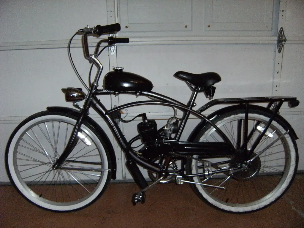

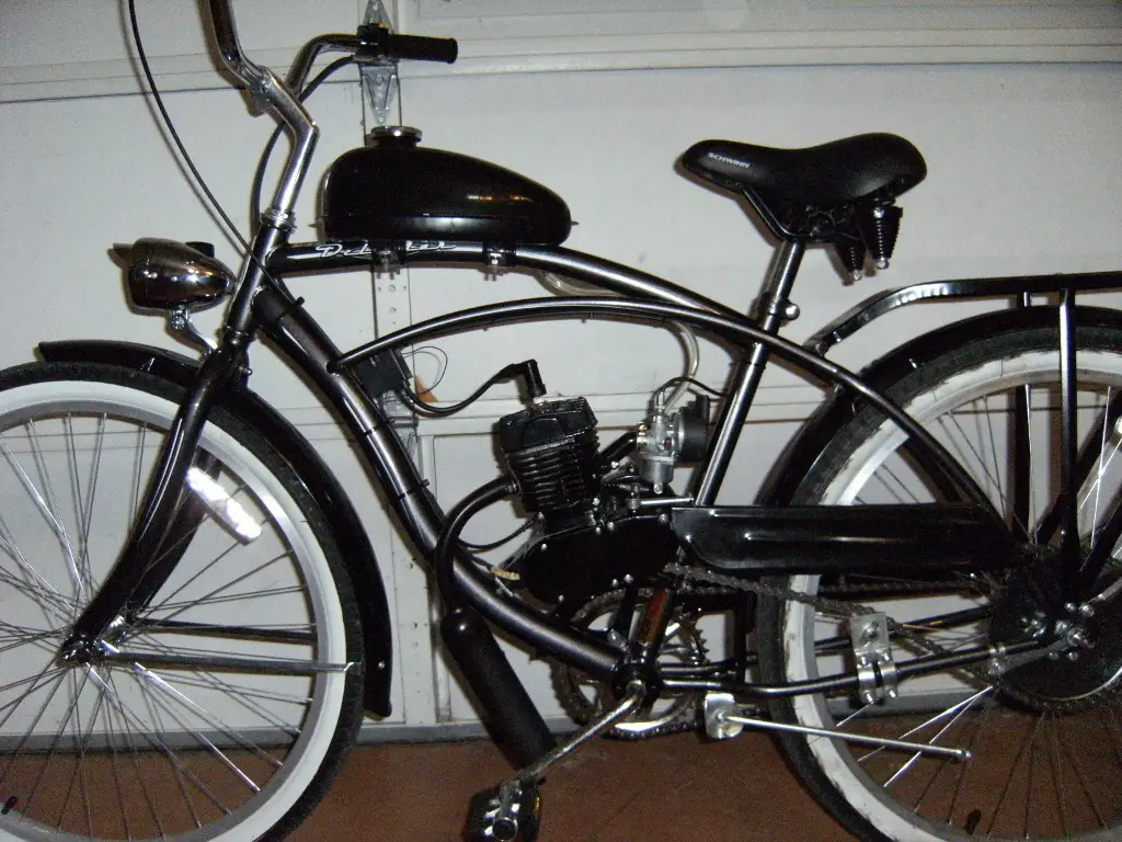

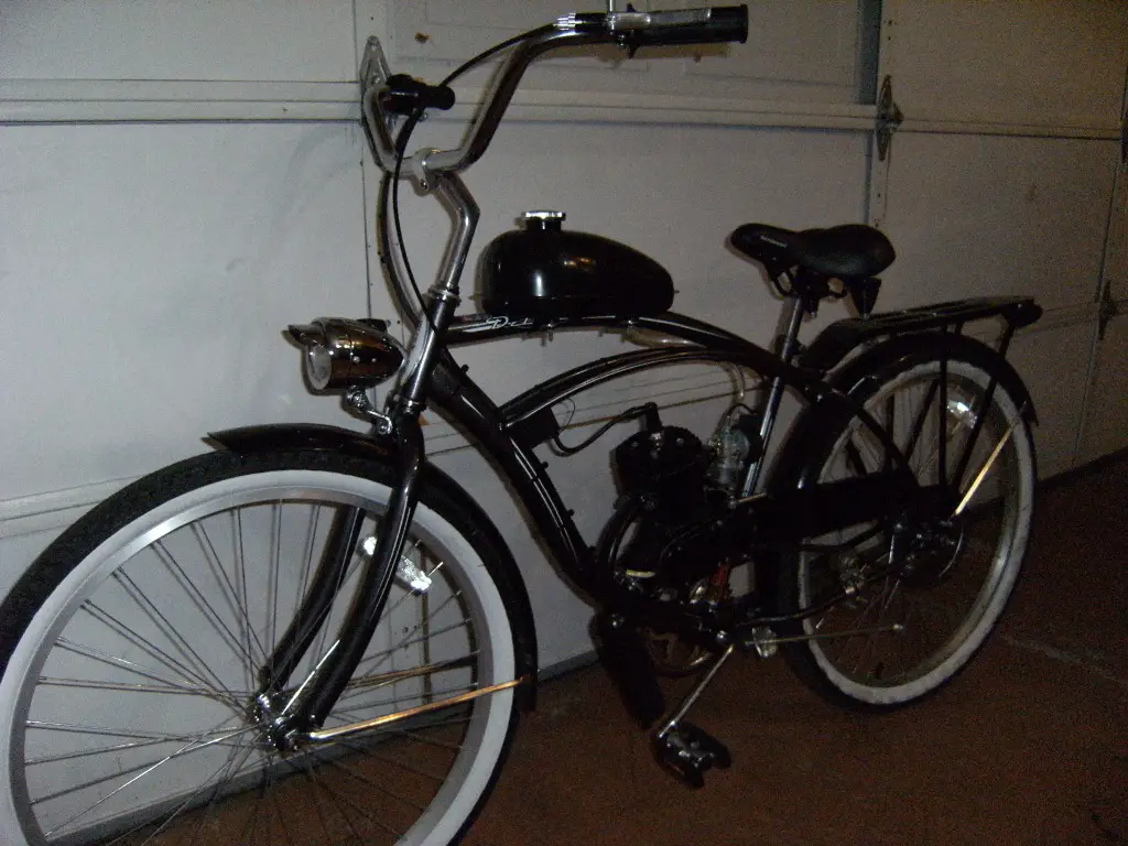

Well my first MB is finished and I am happy with it so far. I know within a few weeks I will be making changes but for now i will tell the wife I am done. It not healthy to lie to yourself is it... I rode it to work Wednesday and Thursday and with the exception getting to learn the engine, clutch, etc. all went well. Still takin it slow on the new motor...

Nice, clean looking bike! I like it. My only suggestion, a front brake for "just in case".

I've been thinking about braking in general. I was thinking about a dual cable grip with rubbers on front and back and then loosing the coaster brake but from what I have read there isn't a whole lot of options for freewheel sprockets on the rear hub. Any suggestions?

I have a coaster rear and disc front on mine. I use the front 95% of the time. I like the rear coaster because it's one less lever to deal with on the handlebars. The thing that scares me about the dual brake lever is gravel/sand on the road. I have learned the hard way (a dozen times, lol) that gravel and front brakes don't mix well at all.

Good point. My other concerns about the rubbers would be wear. I'm afraid that because of the regular speeds the wear would be excessive. I looked at the disk brake setups at a bike shop today and I think I would need to change out or modify the front forks to accept it. It is definitly something to think about...

Yes, You would need new forks, new front hub, and disc brake kit. Very pricey.. I bought my front rim, hub, and tire at my local bike shop and they were more than my motor kit If you got a cantilever brake you could replace the rubbers a dozen times and still be ahead of the game.

An alternative might be a Worksman front wheel with drum brake and 12ga spokes for $99.99, this includes everything but tire and tube. It's on my list of parts to buy. GOOD brakes are your friend. Walter F.

I couldn't imagine running without front brakes but I do get sick of buying the rubber pads every month. Five bucks a month is worth having the ability to stop.
