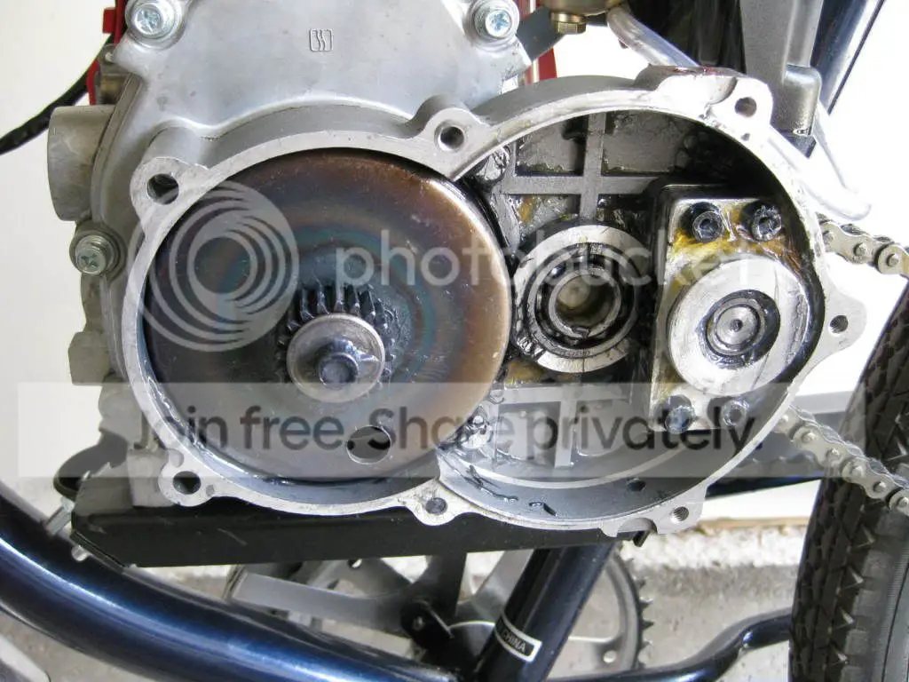

Thanks for the info and your offer. I would like to try and fix it myself first, but I may take you up on that offer if all fails. Do you know where I can get a guide or diagram on how to take apart this gear box? I took all 6 bolts off the side and now I can slide the gear box cover up and down a little but cannot take it off. I looked all around and don't see any bolts holding it together.

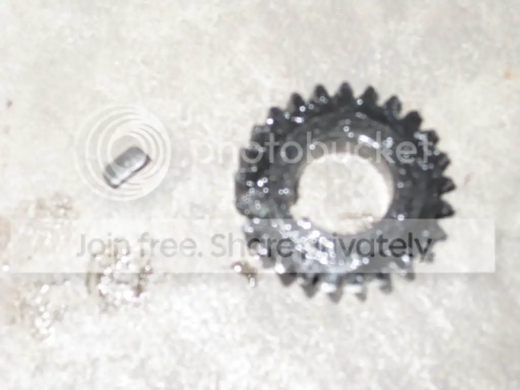

sadly i think the previous diagnoses are not the case for you, i've had the exact same problem and its due to the woodruff key/spline/keyway what ever you wanna call it, in the gearbox being made of chewing gum. I think you'll find the gears are spinning around their shafts....can be mended
All you need to do to confirm if i'm right is open the gearbox cover and either observe them in action or a safer bet is to manually turn them, remove and inspect.
I suspect you'll find tiny flakes of shattered metal (or what more accurately resembles solder its that poor!)

Could you tell me how to take the cover off? As stated above I took out the 6 or so bolts holding the side cover on and there's still something on the inside holding the cover on. I looked all around and don't see any other bolts or screws to undo to take off the cover. Any help would be greatly appreciated, and thanks again for your thoughts on my problem.
