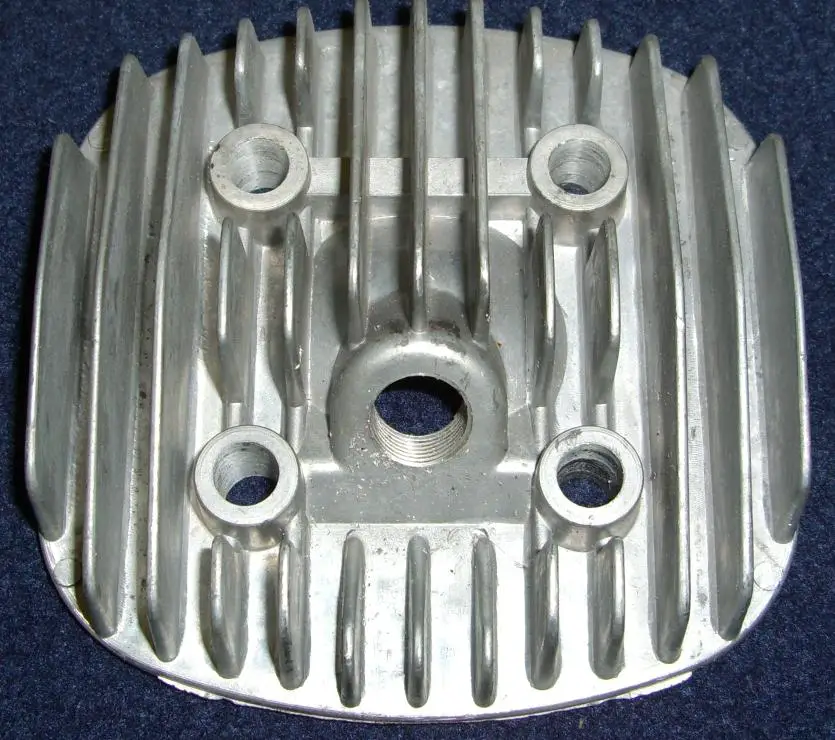

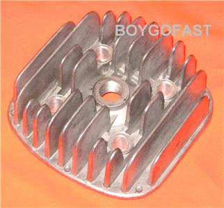

I thought the exact same thing when i read the thread and saw the picture but then I looked a little closer and although the fins are shorter there are 13 fins on the slant head versus 11 on by BGF. I figure that the extra fins will atleast equal the surface area of the original. I guess ill just have to be the test subject on this one -Justin
(slanthead on left, standard on right)

Hi, already have a bicycle with that head installed from factory is the black engine they sell and report no problem from overheating. I live on a tropical climate that 90 F and more most the time and no problems with overheating. Since is my first engine I can't compare, but can say it pulls very good and have some good hills here to test.
